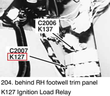

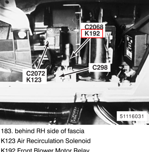

Looks like there are two relays, K127 gets energized first, then energizes K192. K127 appears to be behind the kick panel and K192 is by the blower itself. These power the blower motor and ground is applied though the resistor unit.
Between the 2 relays, the resistor, fan control and motor itself one of these has to be the culprit. Just hoping its not something random like the fuse box that fixed a bunch of other things.

where did you get those pictures from ?
Old Feb 4, 2026 | 11:39 AM
WaltNYC's Avatar
Joined: Mar 2010
Posts: 2,787
Likes: 628
From: NYC
Looks like they are cut/paste from the electrical troubleshooting manual in the "Component Location Views" section.

Yup exactly. They are from the etlj970x manual. You can ctrl+F the connector name and find the photo which helps a ton to locate in the truck.
So it was the K192 relay. I swapped it from a parts truck and the fan started working. The resistor immediately popped though which only allows full blast to work. Im waiting to try out a late 90s Dodge ram resistor which looks the same and way cheaper.
