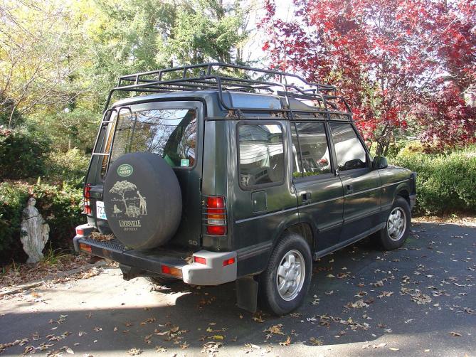

I got the three bolts out of the rear drive shaft and was going to use big zip ties to hold it up. I could not compress the drive shaft enough to disengage it from the rear diff/rubber coupling. So I undid the other three bolts and only two of them would slide out. Still couldn't decouple the shaft from the rear diff.
Here she is.........
Attached Thumbnails Bought a 1995 Disco Yesterday....And....-95-disco-rear-50p.jpg   Bought a 1995 Disco Yesterday....And....-95-disco-front-30p.jpg
Old Feb 6, 2011 | 03:42 PM
Spike555's Avatar
Team Owner
Joined: Jun 2007
Posts: 26,212
Likes: 98
From: Grand Rapids MI

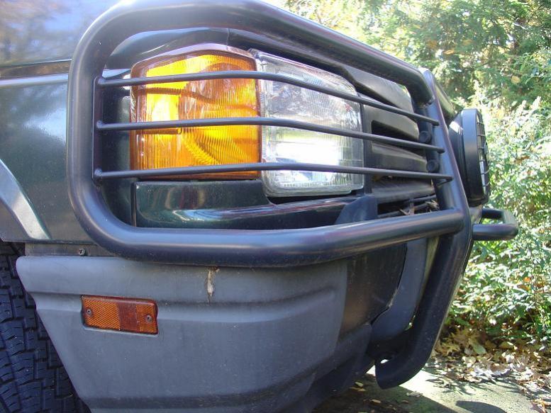

Dude for $900 even if it never runs you got a deal.
The SD rack is worth $500, the ladder $50, the brush bar another $50.
With the other parts you could easily double your money.
You will need to use a pry bar to get the driveshaft loose from the roto flex.

The rack and brush bar have some minor rust but nothing the die grinder won't solve.
What is the general consensus on refinishing them?
Textured Rustoleum?
Has anyone ever used Grizzly Grip?
