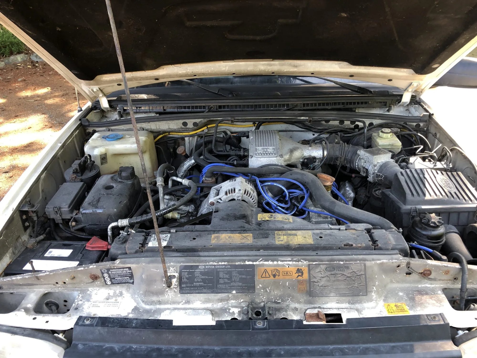

We recently bought a 1995 Discovery 1 V8 3.9L online via auction and will collect it soon. As we're collecting it from Canada, do you see any parts (besides the usual service items) that need to be replaced in order to do a long-distance drive home?

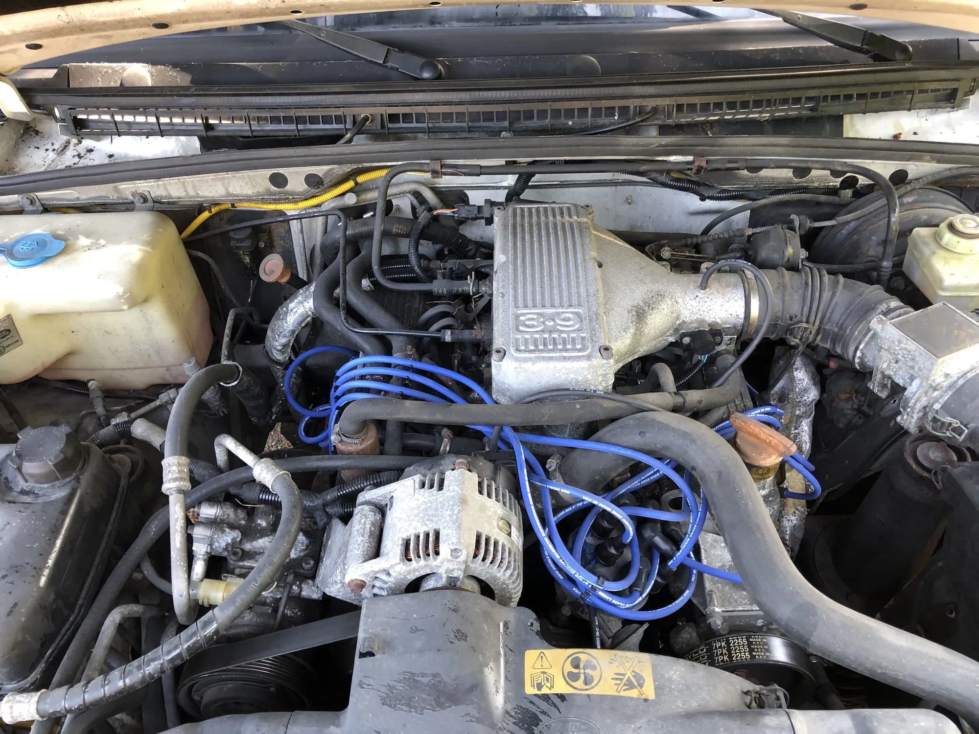

Looks like mine! Engine stops running if alternator breaks, or distributor amplifier, or coil. Overheats and steers hard if serpentine belt breaks. I suppose I would pack those parts. Amplifier needs a tiny torx bit to remove/install if mounted on dizzy. Plugs and wires are easy enough to buy along the way if needed, but the wires look pretty new, so plugs likely are too. Vacuum advance diaphram is prone to failure, maybe check if it holds a vacuum vs leaks through. If it leaks, seal off the vacuum port until you can replace the unit.

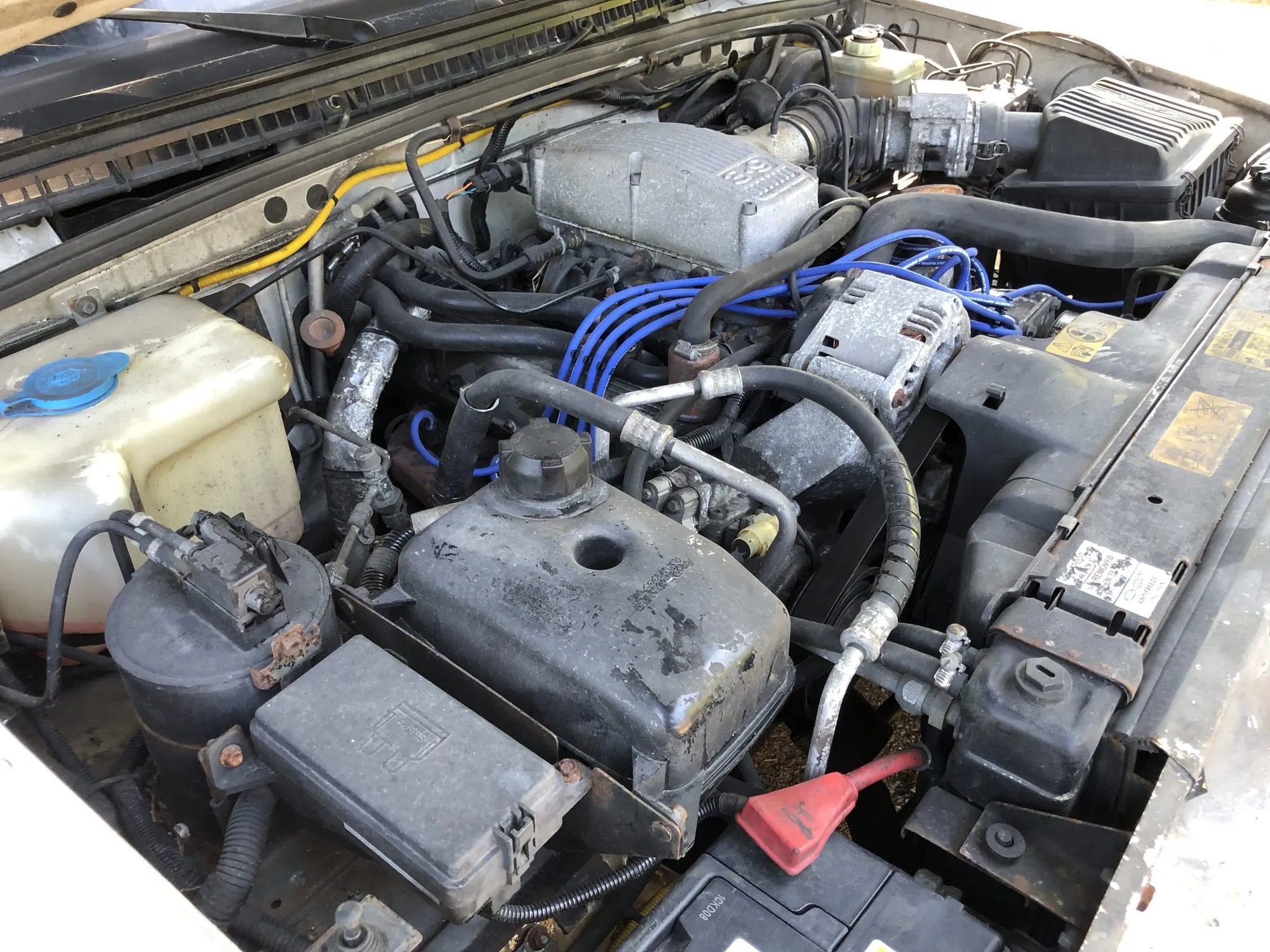

Battery hold down is missing.
Bring extra coolant - I would bring 2 gallons. (coolant reservoir, radiator and head gaskets tend to leak by this age) - keep an eye on your temp alot.

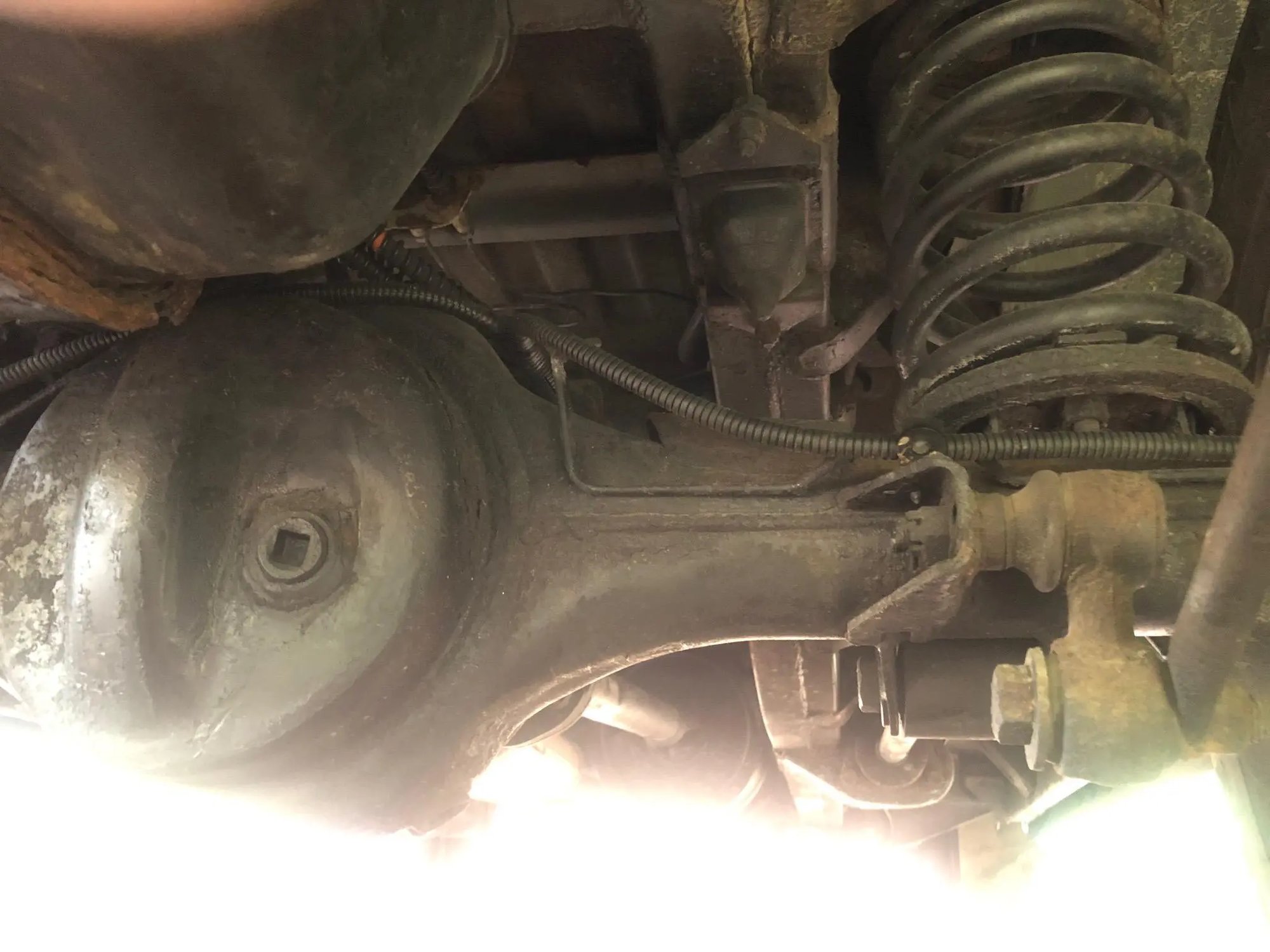

top off all fluids - rear diff looks to be leaking

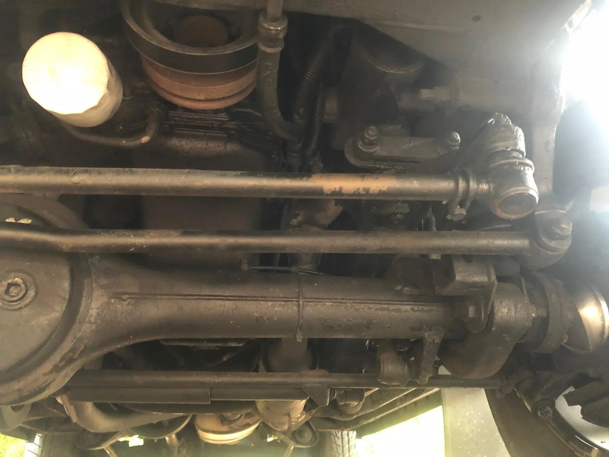

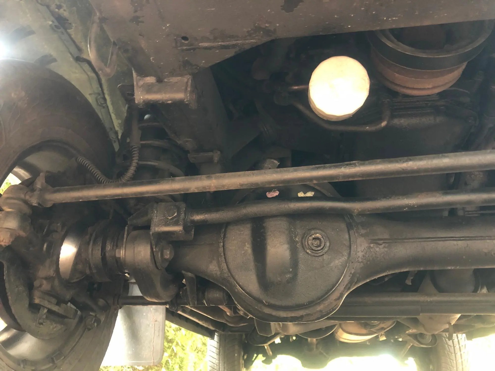

Check the steering damper bushings & tie rids (will give wobble at highway speeds) - lay under with someone turning wheel - look for play in the bushings/tie rods
extra wheel bearings may not be a bad idea
