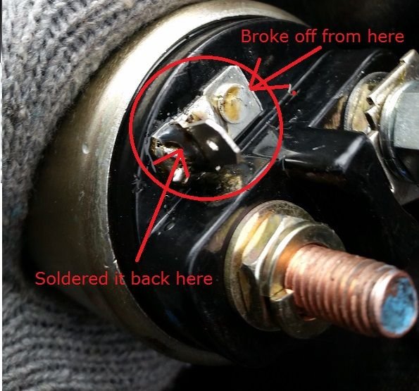

I finally fixed my starting problem today, changed the starter "TWICE", Installed it the first time and when I was about to plug in the ignition wire the ****ing thing broke off of the starter, almost made me cry. I had to pull the starter off again, take it home, solder the ****ing piece back on and put it on again... It started on the first try after that...

Starter is not bad either, its a bit messy but doable. Like I said I took mines off twice yesterday... you will need a 24 inch extender for the top bolt and a Swivel Ratchet Wobble, they are torx bolts so you will need a torx set.
