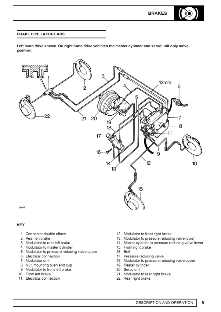

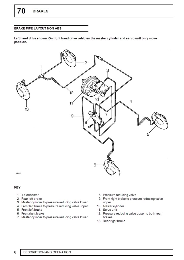

My friend , it sounds like your ABS modulator is toast ,take it out since you are ok to drive without abs brakes , this is D1 there is no traction control on it ,you will just gain good brakes .
