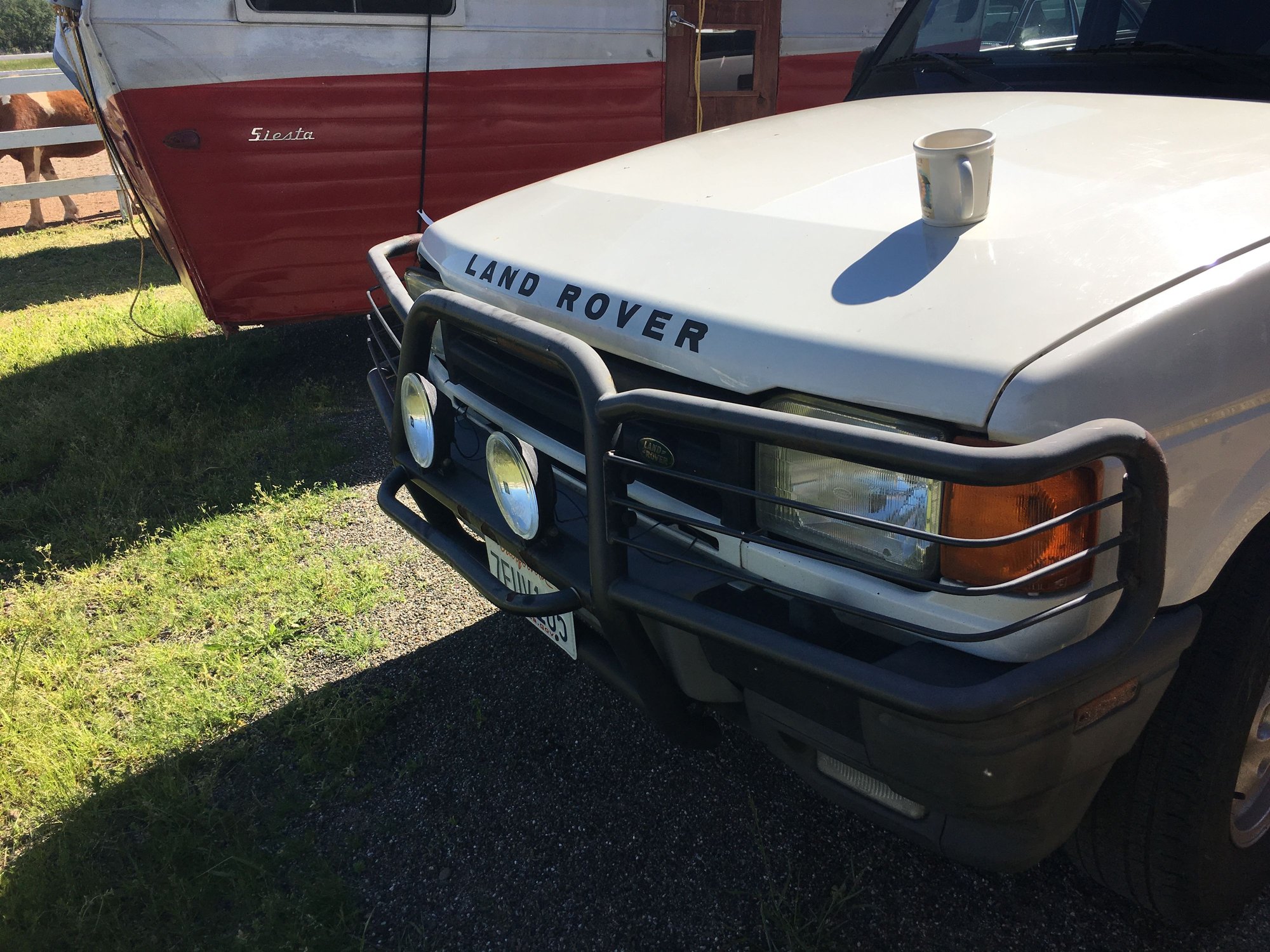

Is this a Landrover Discovery brush guard? It came on my new Disco. It's needs a good refinishing.😂😂

yup.........oem

Hey thx. Most of the Discos I've seen on here don't have the brush guard. Is new powder coating the best way to redo it? Whatever is on it shot. I seen rust all over it so it will need to be sandblasted.

When I found my used one, before putting it on, I treated the rust by painting over it with the fantastic black Por 15 paint; no sand blasting, etc. needed, because the Por 15 treats the rust; sealing it forever. But, Por 15 will deteriorate from ultraviolet (sun light), so an overcoat must be put on that, so I used rubberized truck bed coating. Both were simply put on with brush. Worked great for me, with several years now on the coatings. Por 15 is unlike any other paint I have ever seen or used; it gives a hard coating tougher than hell, though expensive, but worth it. Do a google search or look on ebay for Por15.

The problem with the factory brush guard is more about the internal rust that comes from the inside out.
