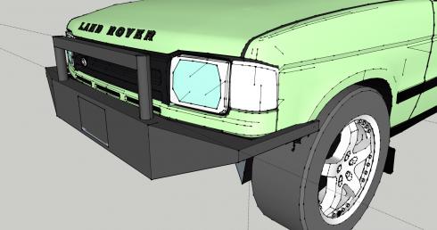

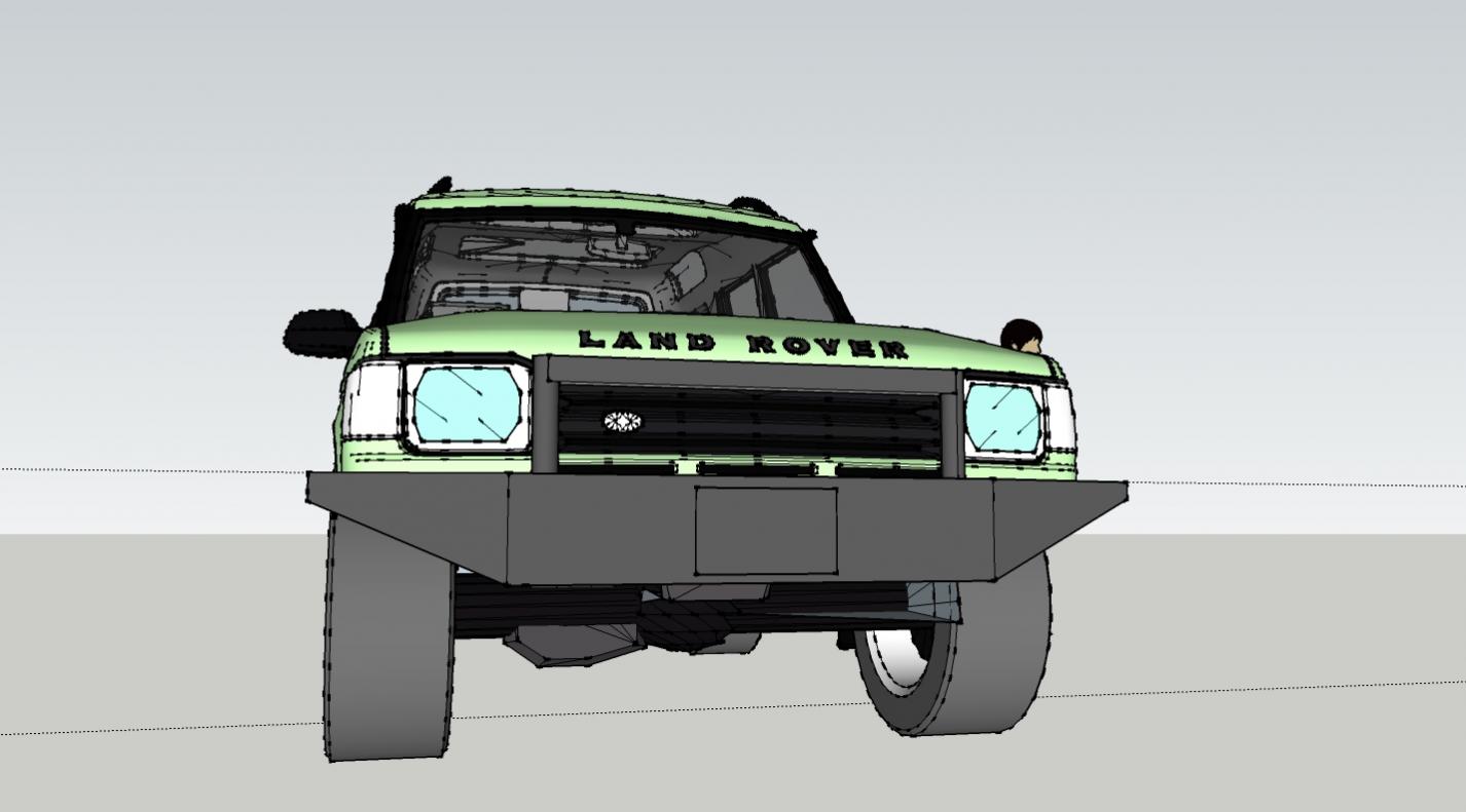

I drew up a bumper thinking I would have my D1 and D2 done. I'm still thinking. DiscoMike made his own and I'm sue would be happy to share. Check his threads. Anything Lucky8 sells is probably pretty good.
The approach angle is how you slip into bed after a full on night out to not wake your wife.
Attached Thumbnails Bumper options - Front and Rear-bumper.jpg   Bumper options - Front and Rear-bumper2.jpg

Not bad but the tubing looks like an afterthought. I like the first one without the tubing but protection might be an issue. maybe a combo of light guards and the first one would look best.

i just reread...your grill guard added to it...let's see......

Use an angle grinder or cut off wheel to trim the fenders. A sawzall will cause the fender to flop around while you're trying to cut.
Approach angle is measured from the front of your tires to the part of your front .bumper that hangs out the farthest. Approach angle is basically the steepest incline you can attempt to climb without scraping or having your front bumper hit.
Geek, good approach angle on bumpers is achieved by keeping it as slim as possible and by sucking it into the truck as much as possible. On a winch bumper it is always a compromise. For maximum approach angle with a winch one will have to trim their grill. However, many people don't like to do this. Departure angle is probably just as important, especially with the rear overhang on these trucks. Unfortunately, the D1's have frame horns on the rear bumper which makes sucking the rear bumper in difficult. That and many people don't want to cut the frame horns and hitch receiver to improve their departure angle.
