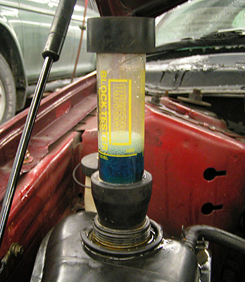

Do it like this, there is some flow thru the heater core circuit, so it should not be blocked off 100%.
However, the sloshing is not the heater core, but air or exhaust gas in the coolant. If can't purge by fast idle with battery side of truck elevated, and that radiator plug removed.... then you could have head gasket issues. There is a $50 ish chemical test that will detect products of combustion in the coolant, changes color. Once you have that, time for HG.

also this tester is that a one and done or like a shop tool? my girls uncle works at a Pep boys hes just on vacation right now, and if its not a one n done i prolly wouldnt have to pay for the test
