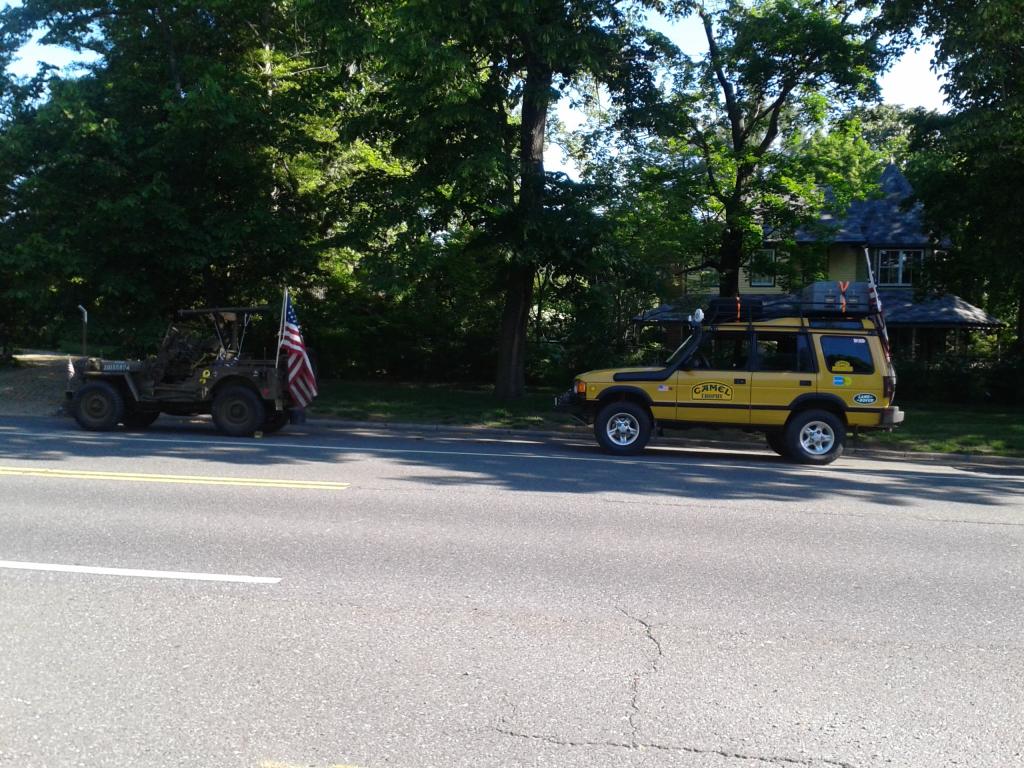

This is just for ihscouts, had the wife drive it in parade behind my jeep today.

Looks great, Tom.
Can you share some details? What paint gun? How many CFM are needed from the compressor? Did you tape the window gaskets and cut the tape around them, or just carefully line up the edge of the tape with the edge of the gasket?
I may be doing this to mine.

Wow Tom that really turned out nice.

if at first........
great job, Tom.
