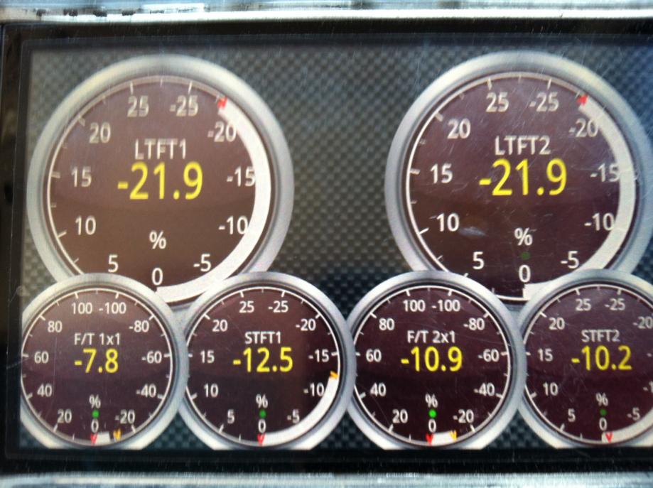

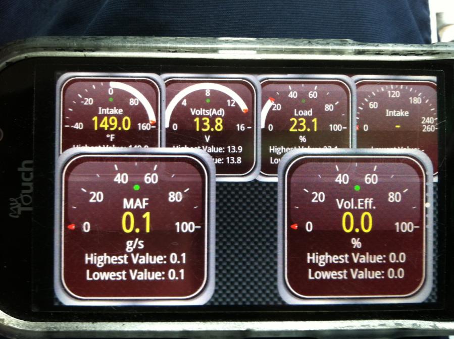

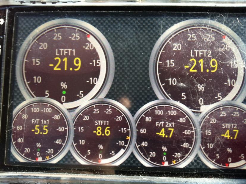

Also just another piece of information according to the ECM my MAF isn't registering at all so the truck is running off the VE table.
@ Disco Mike I did that less than 10 months ago.
@ Savannah Buzz I will go get what I need today and try to resolve my issue asap.
Well it should show something, and it should change. Without the MAF the ECU has a hard time guessing how much air is being mixed with the fuel. Might examine and clean connector for MAF cable.
