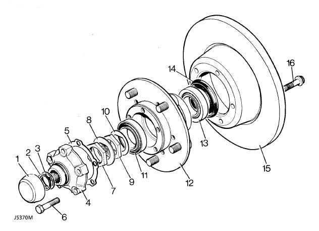

Do you have the cir-clip on the end of the axle shaft? #2 in the diagram

Yes.. circlip was there... took at couple of quick videos to maybe clarify. thx for all the responses. I won't be able to work on it further till sunday but if you see something in the below 2 vids that definitely points to one thing or another please let me know.. 52mm socket is on its way Also ordered inner and outer washer/tab.
