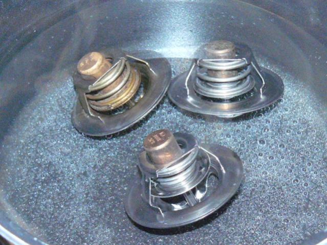

A stuck closed thermostat will let very little water pass, the water pump pressure would be forced through the heater pipe bypass circuit, which may account for the pressure into the reserve container. Suggest remove thermostat and at least inspect, will need a gasket to put it back on. If no stat available, you can pop that one into a pot on the stove and heat it up to see if it opens. You can also loosen the top hose on the water pump and see if any water is passed out when truck is running. Thermostat is more likely than water pump. The pages I sent you have a path chart for the water flow.
