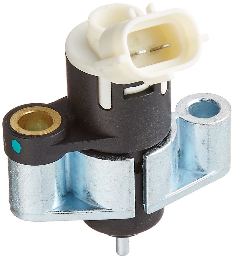

I have a 1998 engine in my '97 and I think the crank sensor/wiring is flaky. Hit puddle in driveway at >10 mph or rain overnight sputters and can't get over 10-15 mph. After a bit and it warms up, runs great again.
Anyway, which one do I need? PC714 (Standard Motors) or a ERR6119? Both on Amazon.
ERR6119
PC714
https://images-na.ssl-images-amazon....L._SL1056_.jpg

ERR6119 is the correct part number.

Good. That's the one I ordered.
Planning on it curing stumble/sputter after wee puddle at driveway speeds and when wet prior to starting.

check the wiring first. both gems trucks i've owned had insulation damage that caused those problems. Seems the wiring for the crank sensor is only good for 15ish years

I've been under the impression that Standard PC579 would also be correct. I CANNOT however verify that.
https://www.amazon.com/dp/B001TEMGEY...I1JE3H5MOHWMXE
