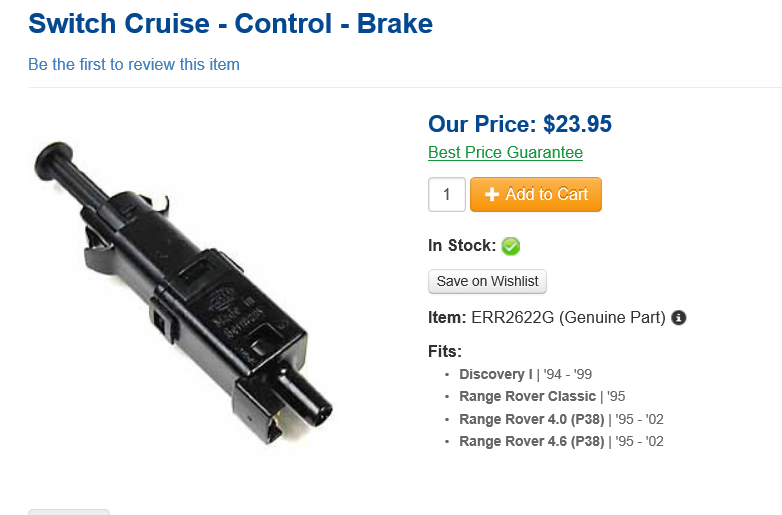

But you asked so re: the Brake/Vent Switch (ERR2622 see pic) it's located above the BRAKE LIGHT SWITCH. The Brake/Vent Switch can be removed without doing anything related to the vacuum hose. Just disconnect the hose and the electrical connector. Or.... just leave it alone. The other end of the Tee/Hose goes to the ACUATOR (ETC7150 see pic ) at the Throttle Body.

Appreciate the help with getting to where that firewall hose resides and disconnects. Sounds simple enough.
