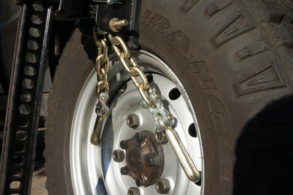

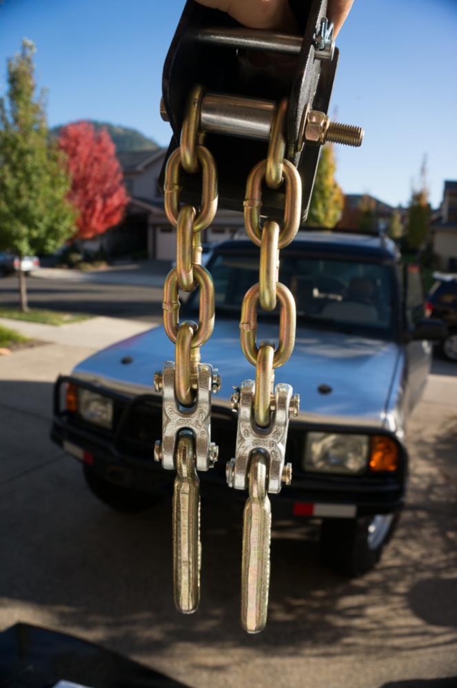

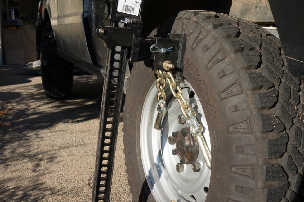

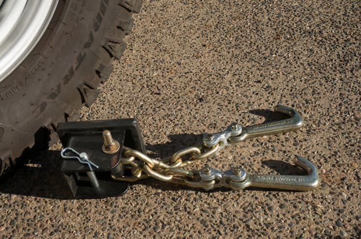

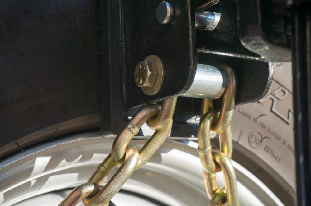

After being disappointed that my Lift-Mate didn't work well with Wolf wheels, I started working on a modified version. The only original part is the black frame, but even it was drilled out to accept more substantial hardware. All components are rated at least 4700 lbs.
