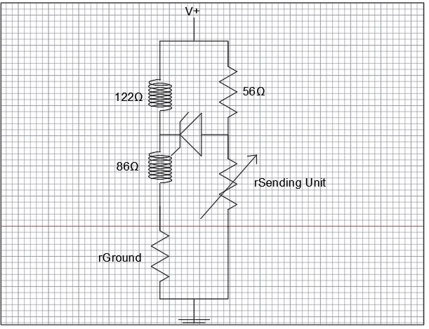

I'd check the battery ground cable. It connects in 2 places, the post right behind the battery on the inner fender and the frame just forward of the passenger tire. Then make sure the ground strap from the frame rail right behind the passenger tire to the engine block is present.
Also, next time it says its overheating remove the brake master cylinder cap to trigger the brake light and see if that changes anything. This will tell you if its the brake cable acting as a ground path or if there is something going on with the ground path of the gauge cluster itself and the brake light is too much current for wherever the high resistance connection is.

The case here is a bad ground from the gauge cluster. The gauge is a balanced coil that shows an almost static value until the voltage after the first coil is higher than the zener diode rating when compared to the voltage after the R1 resistor.
An increase in ground resistance will cause the voltage at that point to be higher and bypass current from the opposing gauge coil, causing the needle to move. The OBD2 port should still report a more correct temperature regardless of the chassis ground problem.

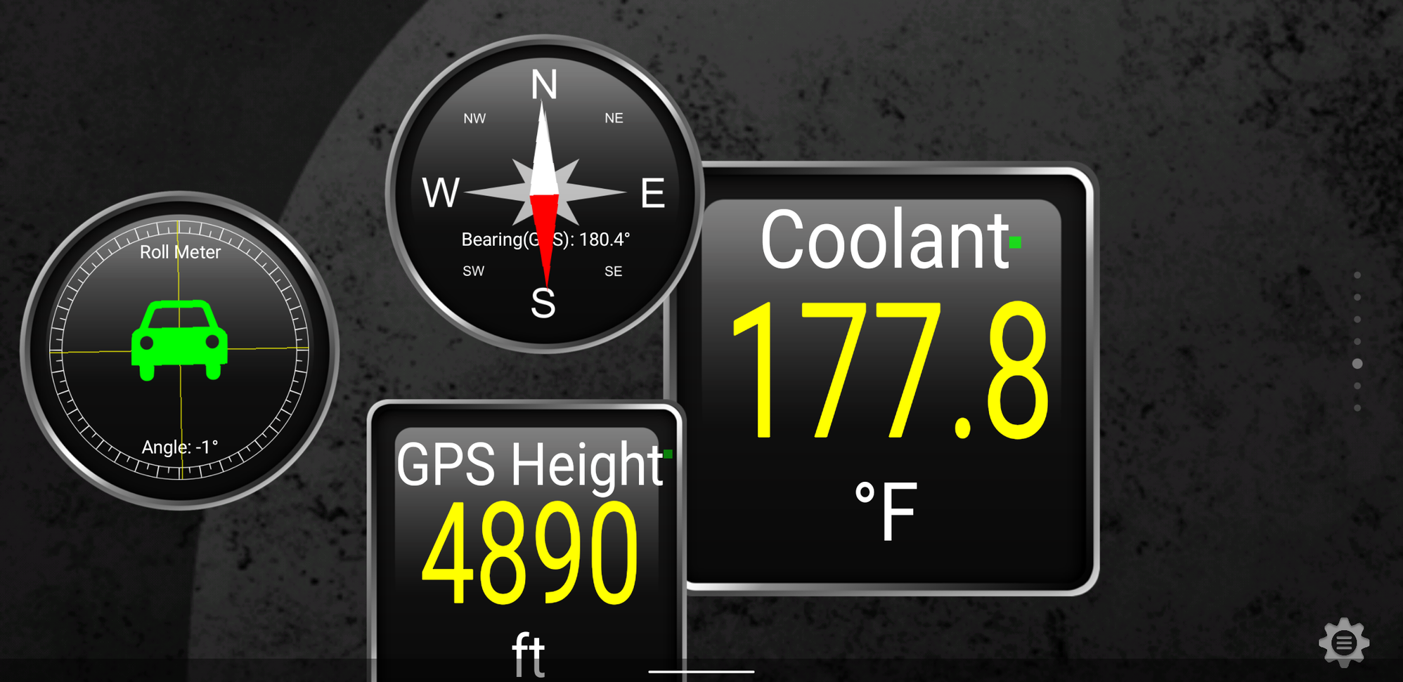

Connecting my obd2 device and using torque on android I saw real-time temps creep up to 99° Celsius /210° Fahrenheit
At this point I am narrowing it down to either a brand new faulty thermostat (it’s the one with the plastic bobble to release air) or air still being trapped in the system.
