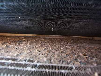

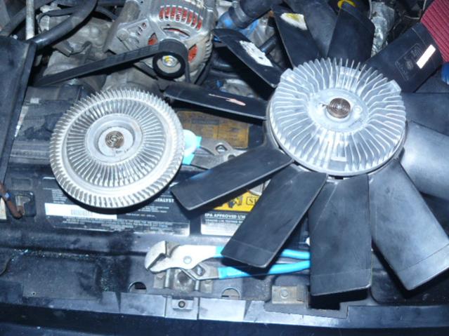

Test the fan clutch first, and the electric fans for AC condenser if you are running AC.. To test the clutch, spin blade and release when cold. Should go just part of a turn, feel like peanut butter inside it. Then warm truck up, turn off, spin again and release. Should not go a whole revolution. Clutch units that freewheel have lost their internal fluid and need to be replaced, a little over $50 (Chevy 2000 Express, 4.3 liter, no AC is the crossover, write up in the tech section). Or salvage yard under $20, late 90's early 2000's GMC or Chevy Blazer or pickup clutch.
But normally if it is just the fan clutch, everything is normal at highway speed.
You most likely also just have an old calcium filled radiator. I suspect since you are overheating or running close to it on the highway the old rad a'int what it used to be. Find an indy rad shop, small, that works on farm and earthmoving equipment. Mine unsoldered the tank, rodded out the calcium, hot acid flushed, and soldered up a couple of leaks for $70. Next step is a replacement radiator, the copper brass one is like $600 if you can find it, and a recent "discovery" is that a firm is making an aluminum one for $232. A clogged up radiator will be colder on the bottom rows, becuase no (or low) coolant is flowing there. More than about 10F change top to bottom indicates this.

There is one more tip that I will throw in on top of everything Savannah said.
Check for blockage in front of your rad between it and the ac coils. Lots of used ones are quite cluttered up at times. You can lift the seal under the hood and see. I have used air compressor and blown lots of dried mud that turned into sandy dust and other debris out of mine after first getting it.

There will be trash trapped between the Radiator and the Condenser no mater how hard you try and get it out. When we did teh swap I found trash 2 to 3" up the fins at the bottom.
