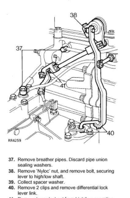

If it feels loose it may be possible that the mechanism may have come undone. You may need to look from underneath, or better view from on top by removing the center console and drilling out the rivets that secure the Hi-Lo CDL shifter, and to make sure that the linkage is all connected and moving properly. If you are going to look at it from underneath make sure to be safe chock the tires, make sure to be parked on a leveled flat surface, and pull up on the emergency brake so the truck does not move.
