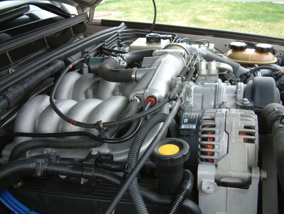

This is a picture of mine, never seen any degreaser used on the top of the engine, just cold high pressure what, by the way, it is now 13 years old and just as clean.
