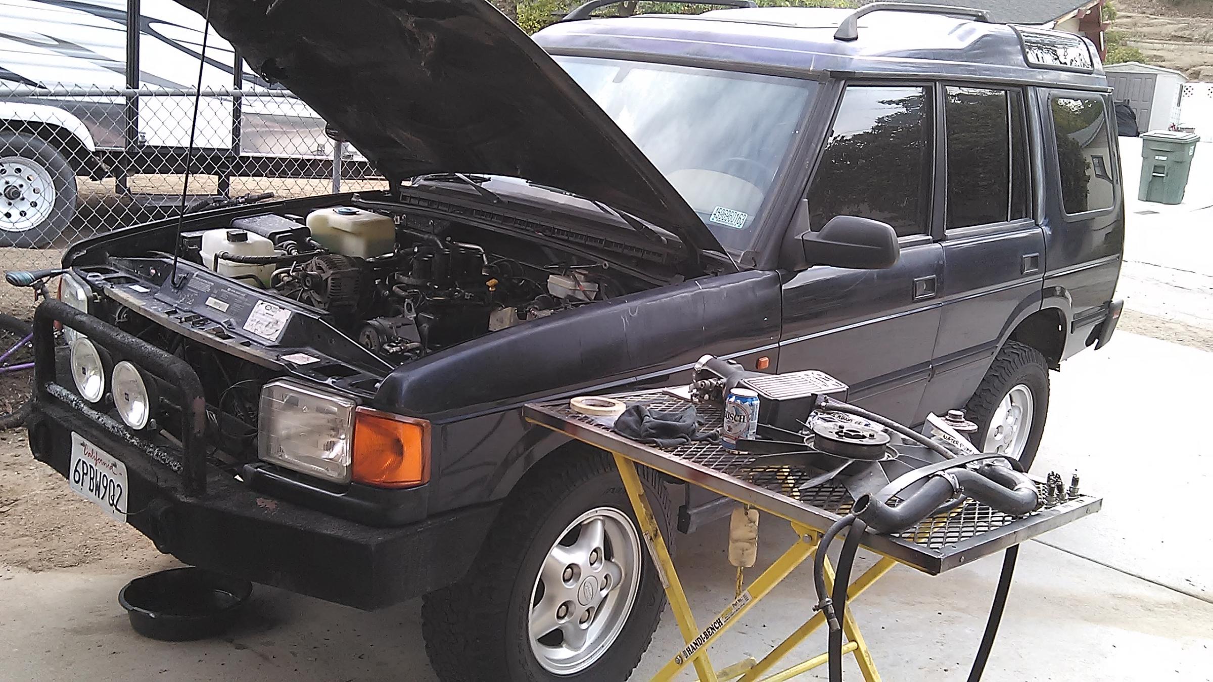

Disco 1 Overheats when in drive...

Yeah man, checked all that already. Even temp wired fans to run on ignition source. No tstat and still hot under load. Did have exhaust gas in coolant but not anymore after blue devil snake oil this past week... Lol. Band-aid on a bullet hole... Compression check, radiator shop are next then I'm gonna start the teardown for head gaskets this weekend.

I can see the flow with the top rad plug out. More than likely still clogged... Yeah I have a tech tool reader the tells me everything from temp to O2 status, to tps reading to spark advances. The 9 o'clock on the dash tenmp gauge is 180-215. I'm guessing that's not too accurate. I'll pull the rad and take it get checked and buy the head gaskets.

Yeah gonna do the rad and head gaskets. O'reilly's has a kit for $267. Comes with felpro hg's, valve cover gaskets, intake manifold gasket etc etc. I'm gonna see if I can fit a different rad on her. I've do with it before with a 1 ton K5 Blazer build I did.
Not sure why the lower hose would be a issue. Do you mean cuz of the angle? Not concerned that angle. I'm gonna give it a try and fit a Chevy or similar type radiator with trans cooling capabilites. I weld and fabricate so I'm not worried about modifying it to fit. I find it hard to believe that no one on here has ever fitted another radiator on these rigs. .
