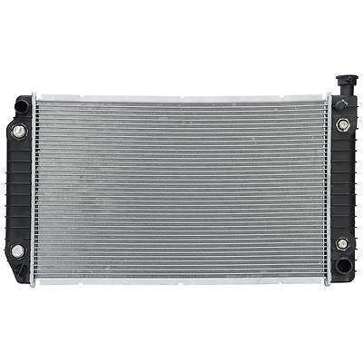

Okay okay! I'll get the heads checked. Geeez.... My apologies for coming off that way. I don't take kind to strangers calling me out (or anyone at that). You guys are the rover enthusiasts and know the ins and outs of these rigs. As for the head bolts being replaced, thats a given. The rods don't look mushroomed to me but I'll ask the machine shop tech what they think. Got the rockers, push rods and valve covers all cleaned up. I let them sit in a tray of gas for a day and all the gunk/caked on oil shyt came right off. Gonna degrease the heads before taking them in and also cleaning up the block. I also ordered a new GM style radiator (different thread). Only $62 online! The one I ordered has EOC & TOC fittings and is used on their 1500/2500 series trucks. Measures 28x17(core) and has a total measurement of 34x19.5. This will clear under the hood. I'm pulling the bottom mounts off the old rad and fitting them on to the new one along with the top mounts.
