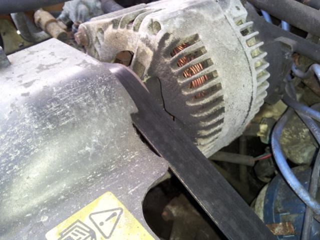

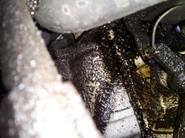

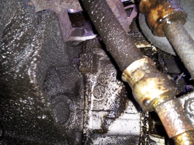

Thought I'd update on my situation. Good news is I didn't need to rent a pressure tester. Bad news is I followed the little green trail back to it's source. The HG's are leaking from the front at a minimal rate. My dilemma is I do not have a garage and only one Rover to drive around with. And this certainly wont be an easy job since everything is so old on her. I posted some pics of where the leaks are coming from incase other people might want to know. The pic of the fan cowl being eaten away by the belt is interesting. Does that mean the motor mounts may or may have not been replaced?
