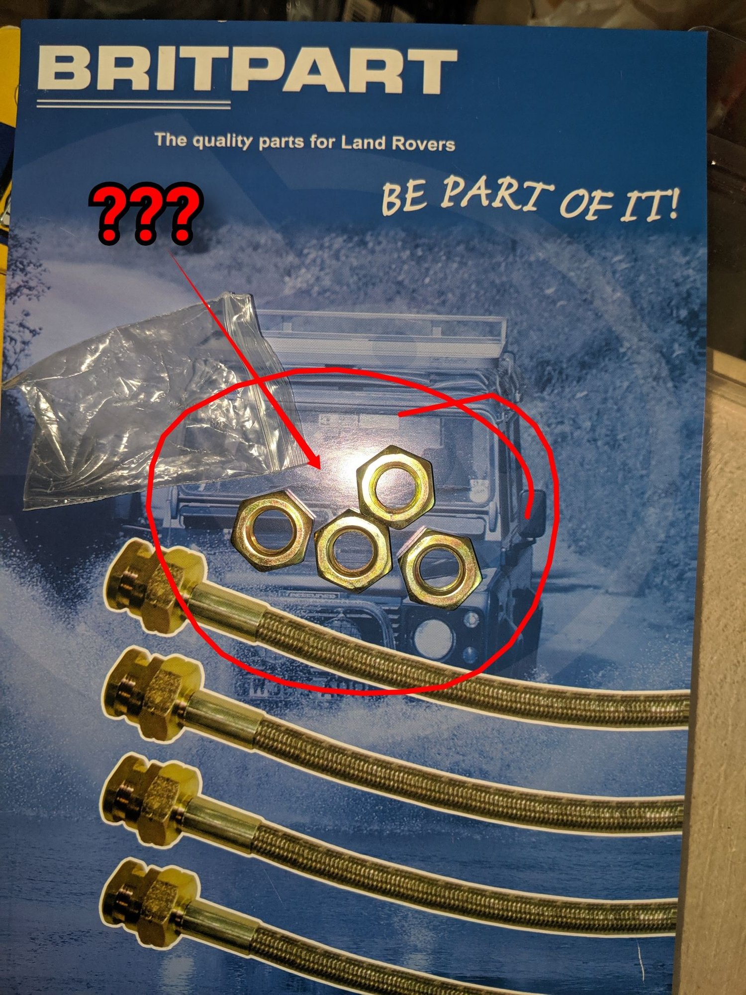

Could someone tell me what the extra nuts are for with the Britpart stainless steel braided brake line kit?
Did I forget to include them during install?
