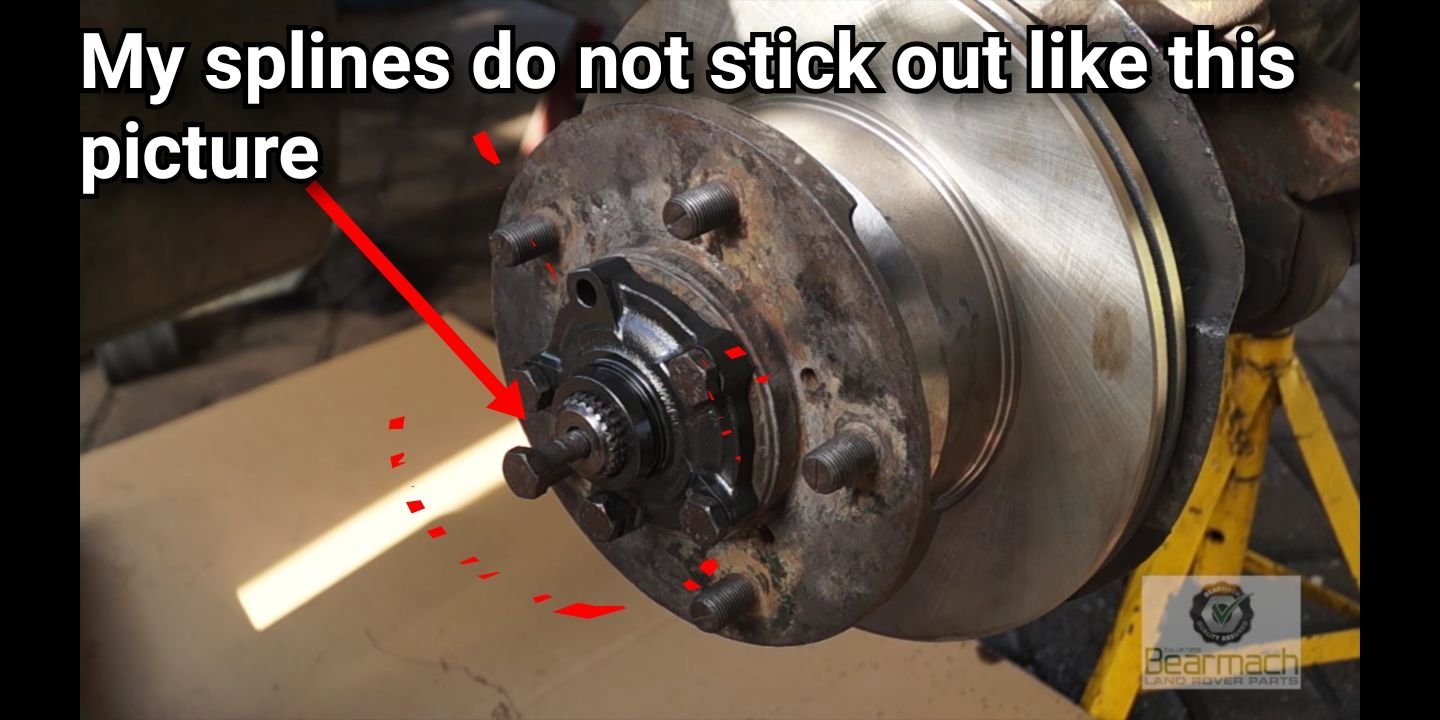

Well, i finally got around to getting one side done. The problem i ran in to was that the splines do not stick out for the circlip (so as in the picture above, my splines don't stick out).
The vented disc and whole assembly has been properly fitted, but the splines not being able to be clipped seems troublesome before fitting the little cap on the end.
Would someone with experience tell me what I may have done wrong?
Thank you

I would check a few things:
Be sure both inner and outer bearing races are seated properly.
Check that the inner grease seal is in correctly with the lip facing towards the stub axle, and that it's seated 4mm into the hub.
This may sound nuts but when you are assembling the hub check that you don't have an extra Lock or Spacing Washer in there.
Adjust the bearings/end float.
Before you install the drive member make sure there's no extra gasket or RTV on the flange.
Once the drive member is installed (minus 1 bolt) use the bolt like in your pic to pull the axle as far outward to clear the groove for the circlip.
And YES you need the circlip!
Good Luck!

Take one of the hub flange bolts and thread it into the end of the halfshaft a few turns. Use you hand or a pair of view grips to grip the bolt head and pull the halfshaft out. It should move out far enough to get the circlip on.
