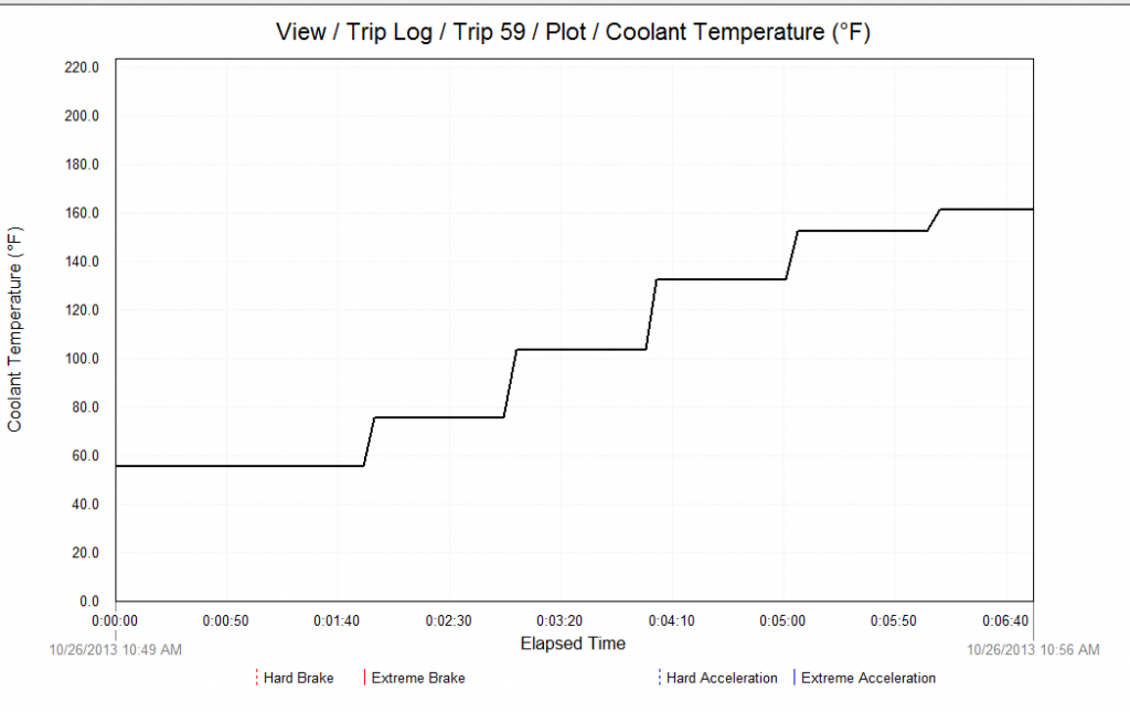

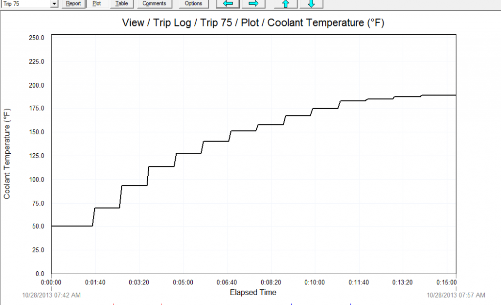

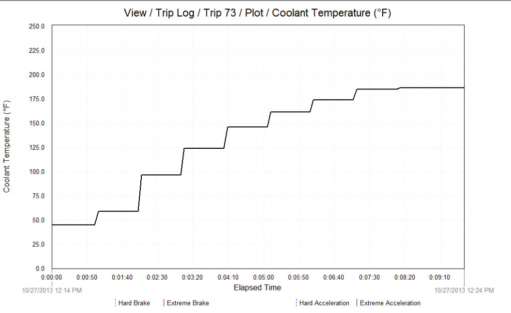

The problem returned after just a few days of blissful trouble free driving... I installed my Car-Chip and logged some data. Below are the temperature plots of my last three cold starts, each of which experienced this problem where it would stall when I come to a stop.
The odd thing that I notice is that once the problem starts, it appears to stay until the disco is parked and turned off even for a short period of time. On one trip while experiencing the problem, I drove about 2 miles and made my usual stop for coffee. But instead of going through the drive through, I parked and walked in. I was in and out in less than 5 minutes and she fired right up and continued on with no issue....
This morning, I started the motor and let is run for 10 minutes and still experienced the problem.
3 trips of 7, 9, and 15 minutes and in each instance, the problem persisted until it was turned off for a short period of time and started back up.

That looks like a fun gadget. If it improved when you cleaned the IACV, but returned...
Perhaps the PCV system is also clogged and causing IACV to get more gunked. On passenger side valve cover is a vac line from the oil separator to the intake. Pull out separator (squiggly plastic noodle) and de-gunk. Then on driver side find line from valve cover to the throttle body. It does not have a separator. Normally filtered air from is sucked into the driver side valve cover, passes through the valley area, and out the passenger side to be burned in the engine. Under certain conditions the flow is the other way, thru the valve cover with oil-laden vapor and into the throttle body. I pulled mine out and cleaned down inside the bore with a Q tip soaked in carb cleaner. It was a lot of buildup, and vehicle ran better afterwards.
