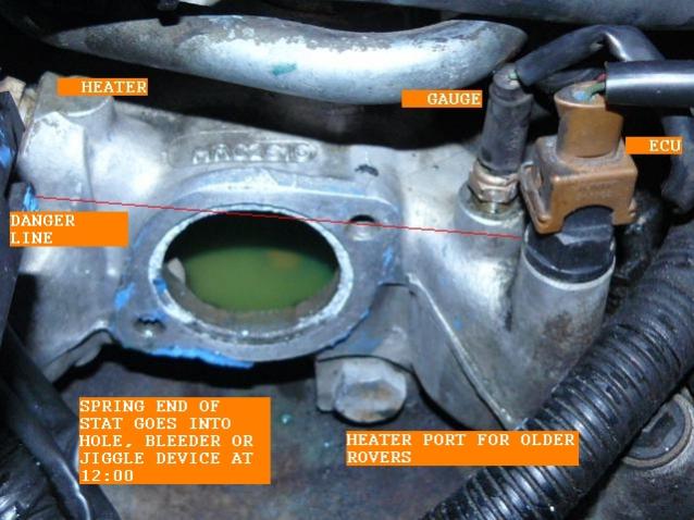

Yep, forgot that one. The ECT should show a logical value on your scanner, like ambient temp in the parking area. Not -40F (disconnected). On a D1, the heat gauge sensor and the ECT sensor are separate, but stand beside each other. Can make high idle. One with brown square top in pix.
