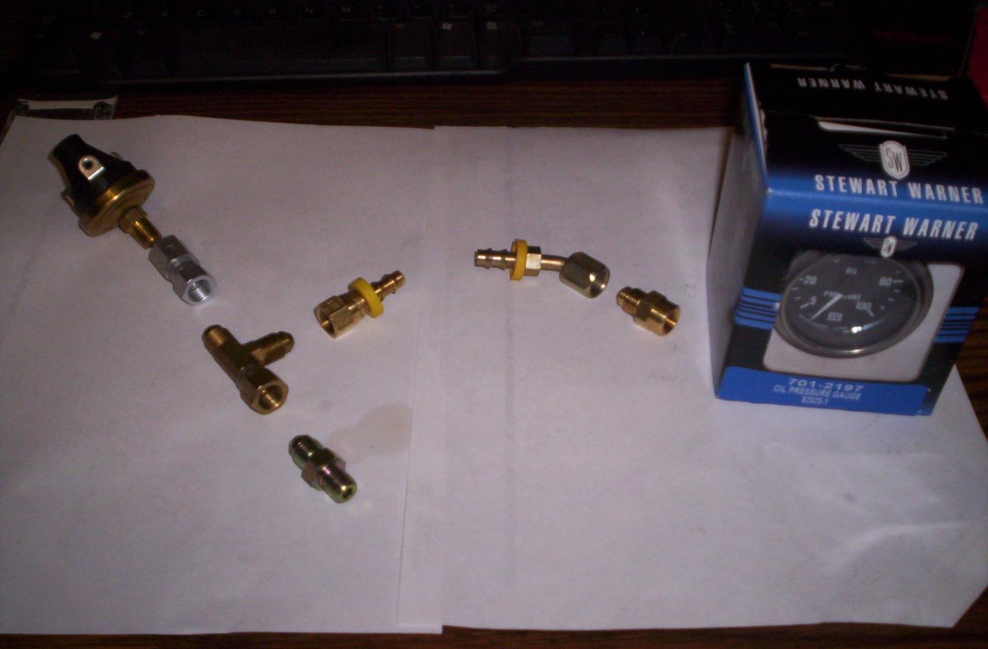

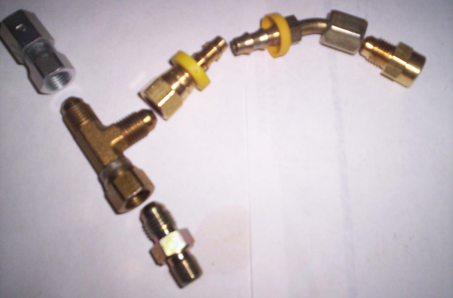

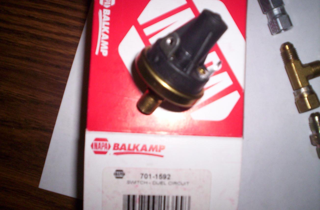

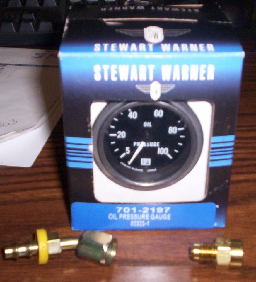

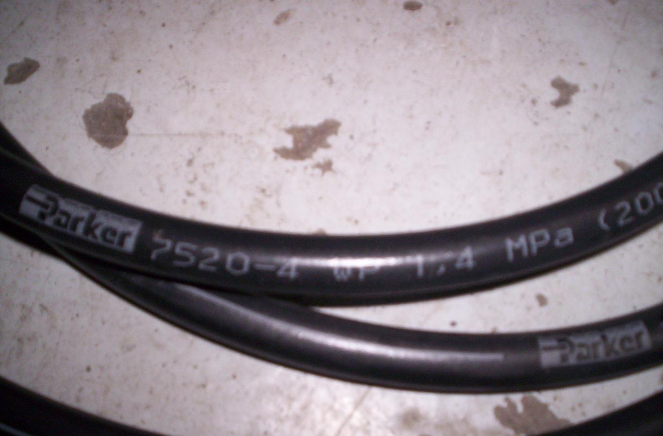

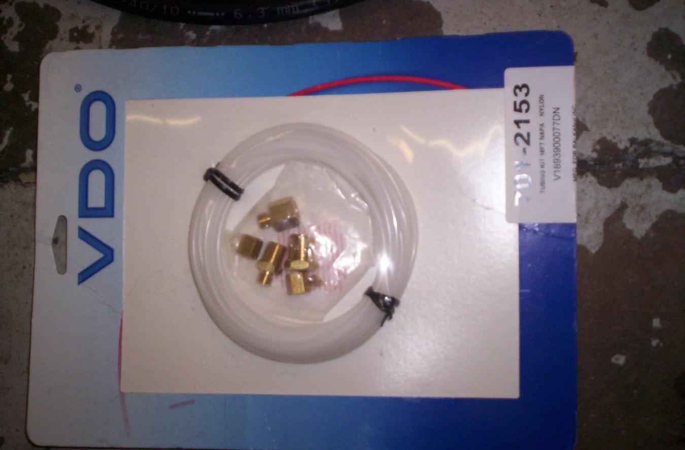

Default Here is what I put on my tracker...
the pics and NAPA part numbers.
Attached Thumbnails Engine Oil Pressure Adaptor-701-1592.jpg   Engine Oil Pressure Adaptor-701-2153.jpg   Engine Oil Pressure Adaptor-701-2197.jpg   Engine Oil Pressure Adaptor-adapters.jpg   Engine Oil Pressure Adaptor-hose.jpg
