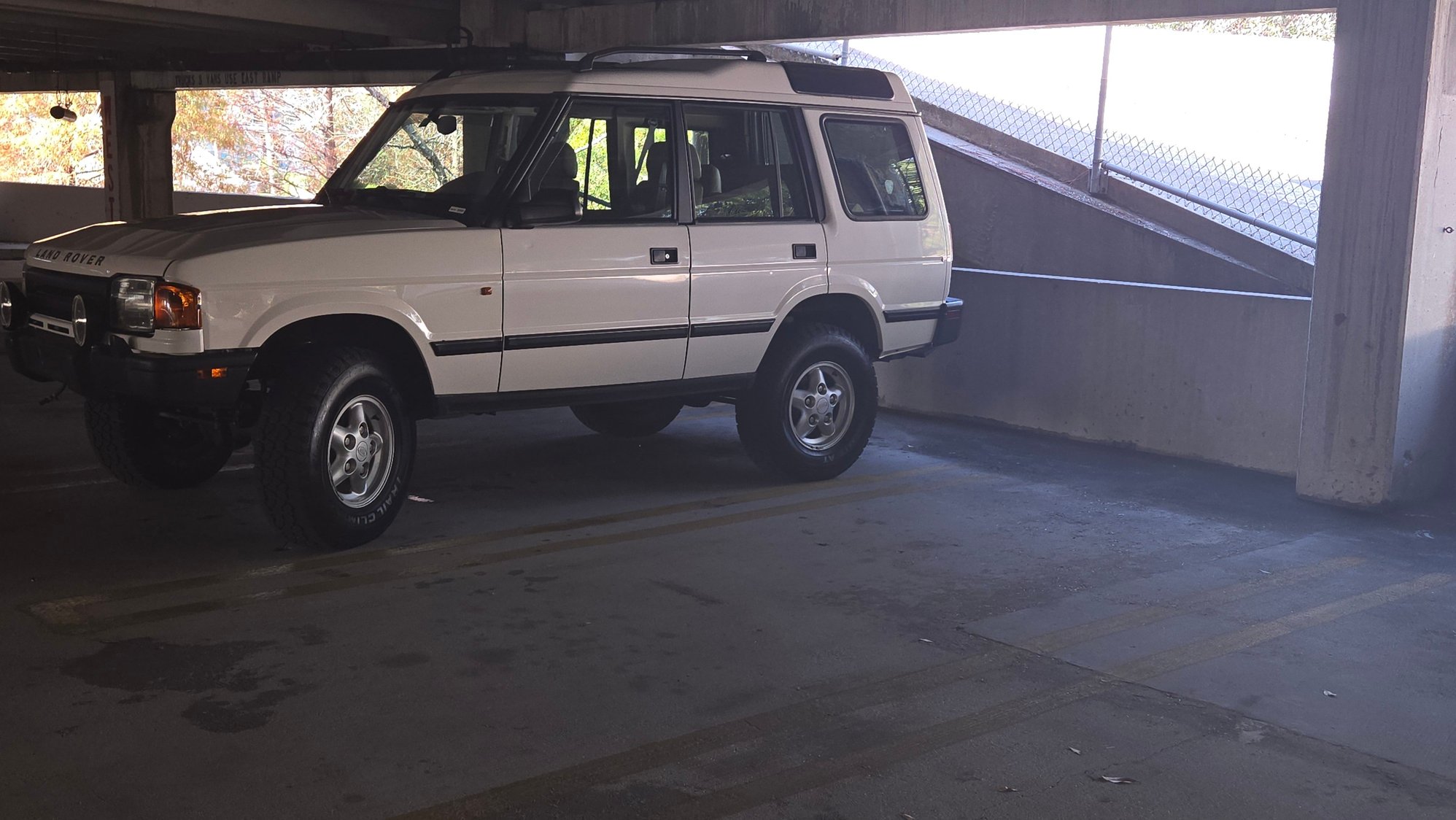

265/75/16 on a 2 inch terra firma lift for reference...
And without lift (mine definitely self clearanced before the lift was installed.)
