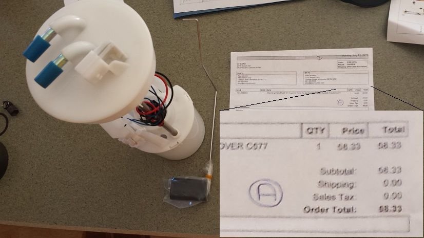

Well the part that was supposed to get here on or before Aug 1 arrived today and I just took it out to the Disco, plugged in the electrical connection, turned the key and I could hear the motor going... My new pump-to-tank seal came today too so I am pretty much all set to install this thing, but I forgot to order the little compression nuts and olives for the compression fittings. I was able to salvage the old nuts (one may not work since I had to dremel it) but I'm wondering where I can get the olives locally? I know I can order them from ebay for about $6 but then I'm out of commission for another 5-6 days. I've read that other people have used 5/32 ones. The only thing any of the auto shops around here carry are standard sizes. No metric. Any ideas?

Looks like somebody owes somebody an apology. (Roverlady1)
And you don't need to crimp anything. As you already know you need a new nut and olive, that's it.
I thought the nuts/olives were standard 5/16"......
See what Home Depot has. Bring the good nut with and match it up.

Fish, I think you may be right about the 5/16. I just measured the tube with a caliper. and it is 5/16. I 'll haul my nuts up to menards (LOL) and see if they are the same threads too. I was assuming since they came off a rover that they would be metric.

just got some 5/16" compression sleeves from Menards and they fit very nicely on the tubes coming out of the pump. The nuts, I believe, are indeed metric. 12mm possibly with a 1.0 thread pitch if I'm reading my gauge right. Unfortunately I didn't have a 12MM 1.0 tap in my set, but I found that I could use the 10mm 1.0 tap and run that inside the threads by hand to clean them up, so that didn't work out just too bad. I'm going to try to use the nut that I dremel'd and put it on the incoming tube - I believe there is less pressure on that line.

Regardless, notny41, could you post up a link to where you found the fuel pump and assembly for $60.00? I'm guessing it wasn't Partsgeek.
