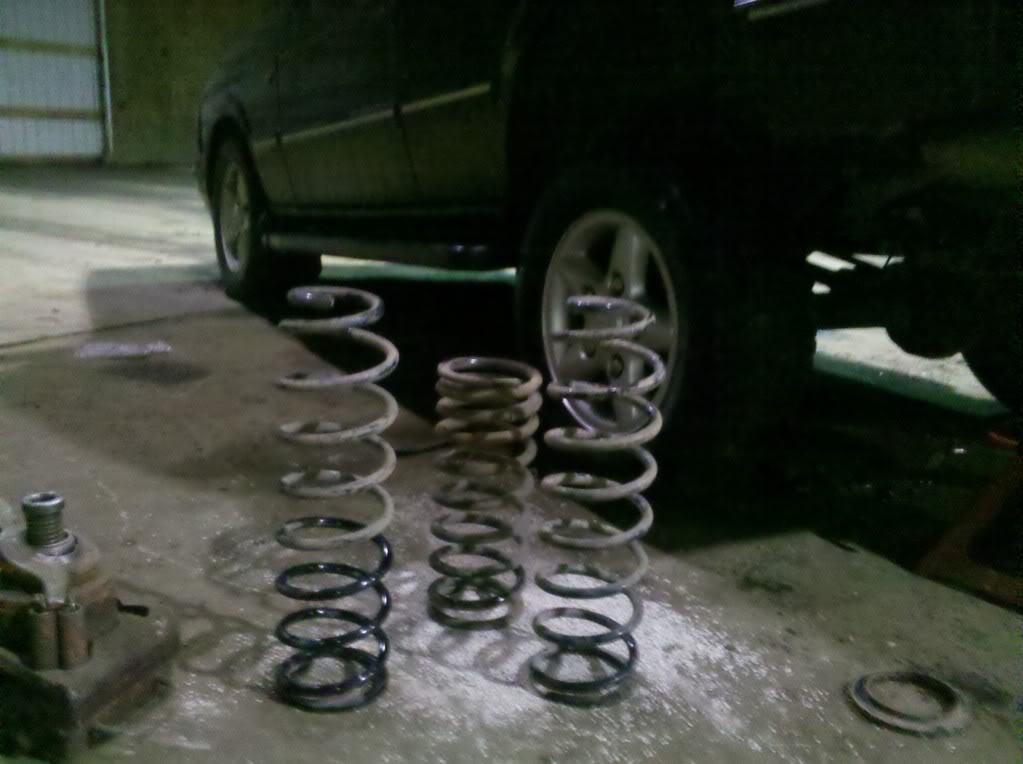

Old Feb 17, 2012 | 02:58 AM
DiscoIsNotDead's Avatar
Posts: 55
Here's rear comparison of springs:

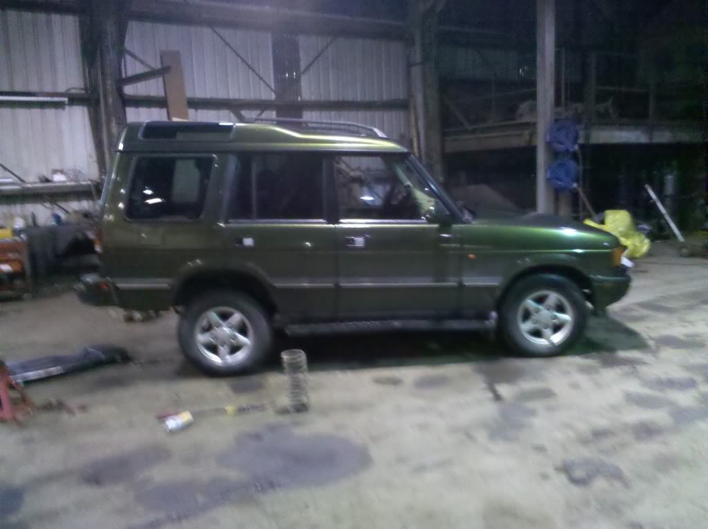

Old Feb 17, 2012 | 03:10 AM
Posts: 55
Yes! The rear perches flpped will accommodate the 'tapered' FJ coils. BUT they will need longer bolts. So expect to include that in overall cost. Speaking of the cost, I thought this the '$50 lift' option. But went to wrecking yard for rear jump seats and found FJ sitting on frame. Found coils on rear floorboard. Told guy @ counter they were outta land rover NOT land cruiser. (Be advised, these are used by 4runner guys for lift also. And are in high demand. ) I already paid $10/person deposit for reflective vests for a friend and I. (Safety reasons @ pick-and-pull) so I asked to call it even for the 'land rover coils' for the deposit. (There were 7 Discoveries and only one land cruiser!). So I got coils for $20

Old Feb 17, 2012 | 03:29 AM
Posts: 55

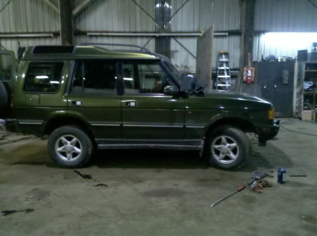

Old Feb 17, 2012 | 12:21 PM
ihscouts's Avatar
Joined: Jan 2010
Posts: 4,245
Likes: 402
From: Traverse City MI
Nice LSE and noticed the RR TWR wheels. I've been looking for a set of those myself. Have back coils in the front yet?

Old Feb 18, 2012 | 12:39 AM
adigerol77's Avatar
Joined: Jun 2010
Posts: 594
From: Mesa, AZ
How long are the replacement bolts? My '97 has been my dd for the last year and with a new job, I got a new "car" for my dd and get to work on my bb. I also have a set of fj coils I got for free.
Old Feb 19, 2012 | 04:14 PM
Posts: 55
Thanx 4 the kind words! Ya its a 98 50th anniversary ed. LSE (pioneer amplified stereo and cargo matts as far as I can tell is only difference) maybe that explains the Range wheels? I always wondered how I lucked out cuz all the other discos I see have HIDEOUS wheels! And the shop is my work, its a truck shop and before that it was a train yard shop. Its the size of an airplane hanger, and has an on site fastenal, so I'm not sure the bolt lengths for the rear, just grabbed a few different length 5/16" fine bolts.
