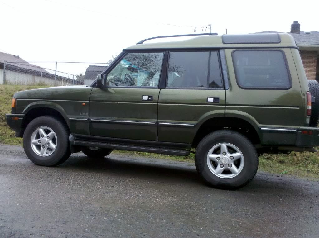

Front coils on with factory (serious, factory michelins!) 235/65
Old Feb 19, 2012 | 04:42 PM
DiscoIsNotDead's Avatar
Posts: 55
New 245//75s to fill fender gap.

Coils are from FJ80 (90's land cruiser) FRONT coils. You put the FJ FRONT coils on the rear of the Disco. The FJ coils are tapered, and the disco coils are not, this means the coil perch must be flipped on the rear, and the FJ coils seat perfectly. After the rear is done you use the DISCOVERY REAR coils in the FRONT of the DISCOVERY. Hence, 2" lift rear and (theoretically) 2" front. If using on Disco II I've heard it will lift 4'' which seems plausible since many of the OME lift springs will say that they work on either but lift Disco II more. This is what I've HEARD but I personally KNOW that they lift the Disco I. Personally I think the rear sits alitttle higher, but oh well. It cost me $20!

So if that's the case looks like I got LX450 20.25" coils. If I had known all the different lengths available i'd had gone for the 19" ones. As mine sits alittle higher in back now.
