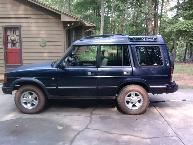

Before
After
Finally got my 91 FJ80 9.25 wrap coils on. I am very pleased with the outcome. The rear was sitting just under 3" of lift but I think it has settled out some already since driving it. The front end is exactly 2" of lift. It drives very well but I do have two questions. I have never owned a straight axle truck before the rover much less lifted one. After installing the springs the steering wheel is slightly off center when going straight. Do I just need to get it aligned or did I mess up along the way . Second is I randomly get a very slight vibration once in a while and it doesn't seem to do it at any particular speed. Not sure what thats about other than just throwing off the stock suspension geometry. Any input would be appreciated. Thanks.

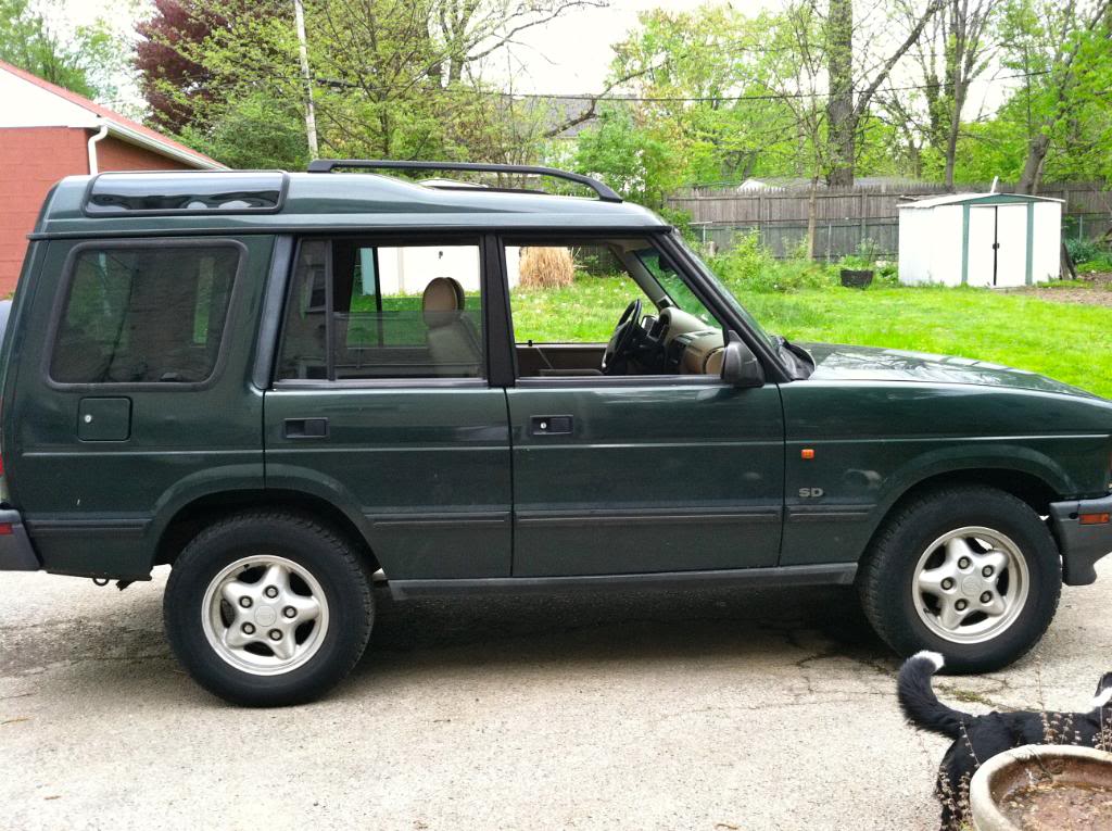

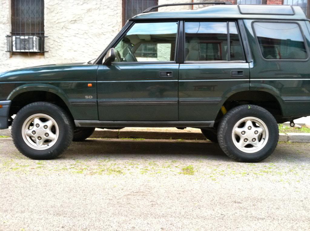

Before
After

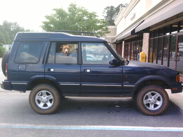

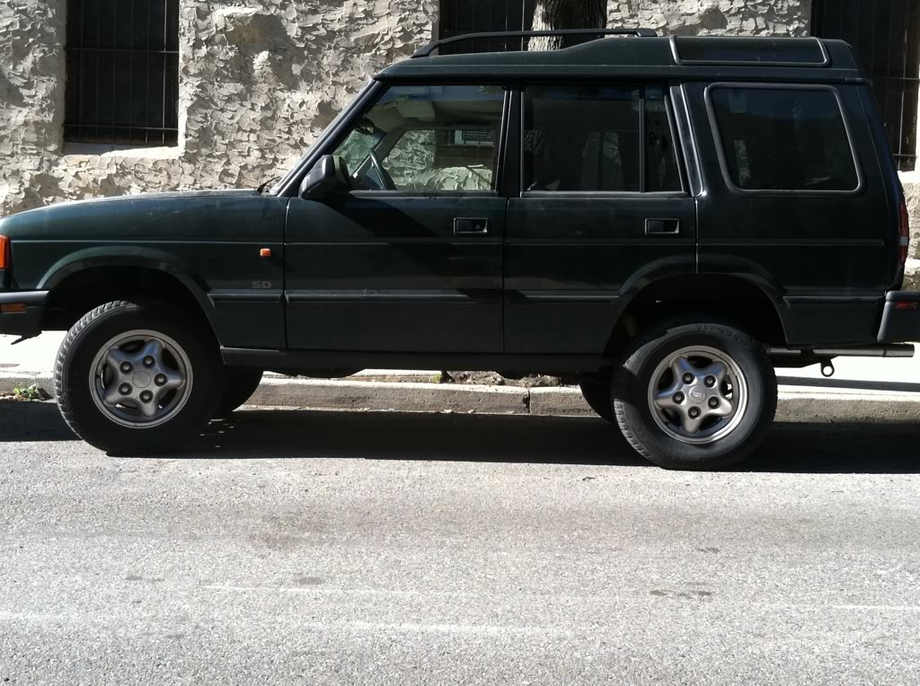

In the spirit of recent lifts.
Before:
After:

I cut out about 3/4" all the way around on the front. The rear end has settled down to 2.5" of lift and I'm really happy with it. I have the rear flares as well I just haven't gotten around to putting them on.

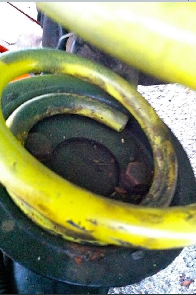

This is what I'm talking about. notice the bolt head inside the cup. Because they're flipped you've considerably icreasedthe length those bolts need to be to reach from the plate, which should be running across the top of the lowest bit of spring, all the way through the retaining cup to the bottom. Am I being clear?
