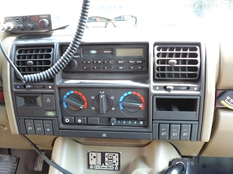

Here's what I would do. Shoot Paul Grant a message and ask him for the stock Fog light switch that goes next to the the Cruise switch and the pigtail for it. Find the pin out diagram and wire up the stock switch for your new fog lights. Draw power right from the battery and add a fuse in line. Use a relay. Tap into power for the parking lights to backlight the switch.
Back when I had a bunch of lights I set mine up like so. Nice and sano!
