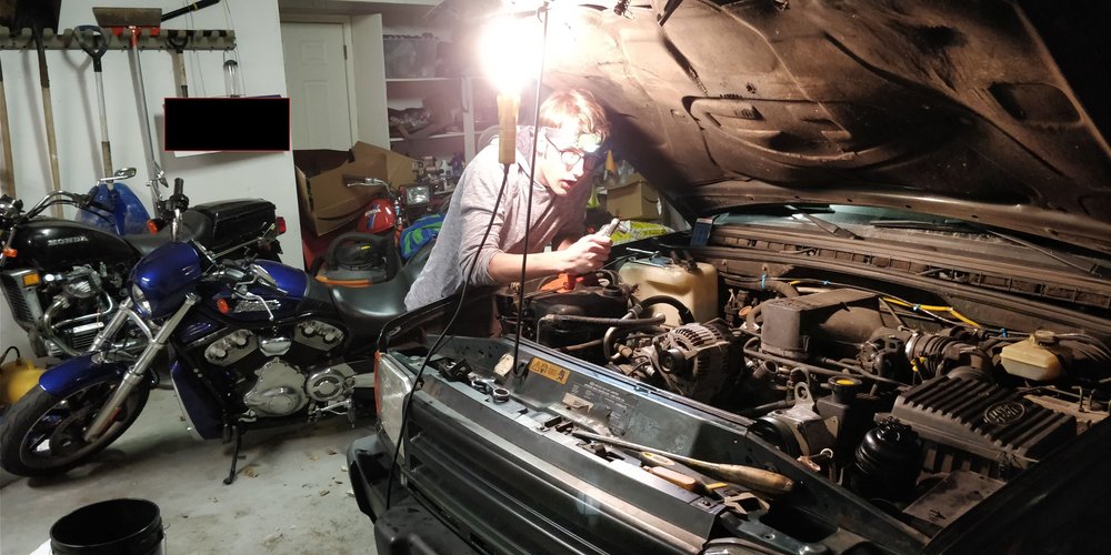

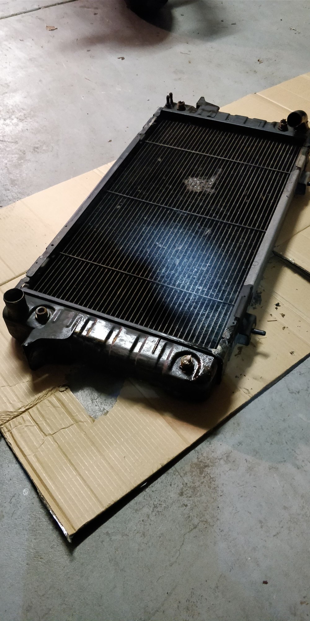

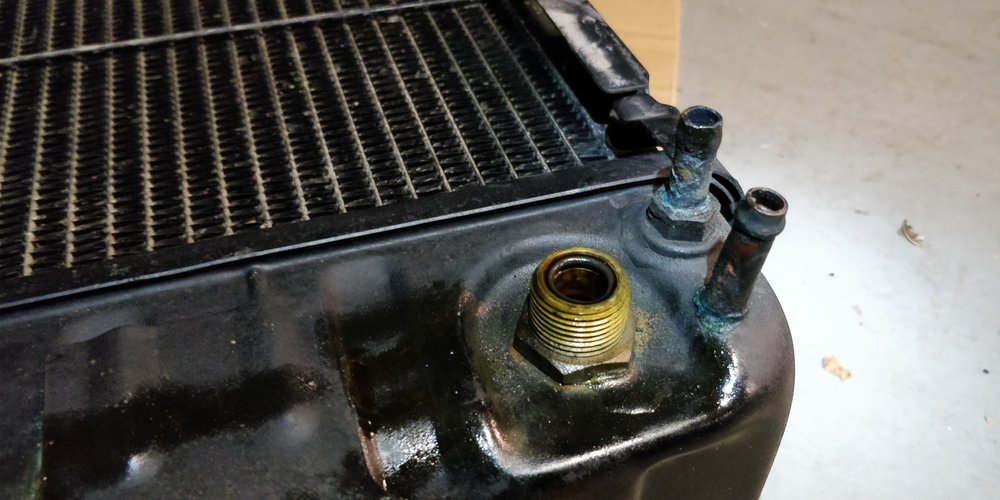

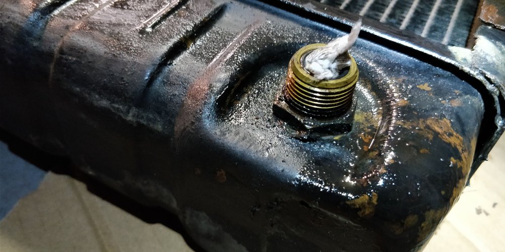

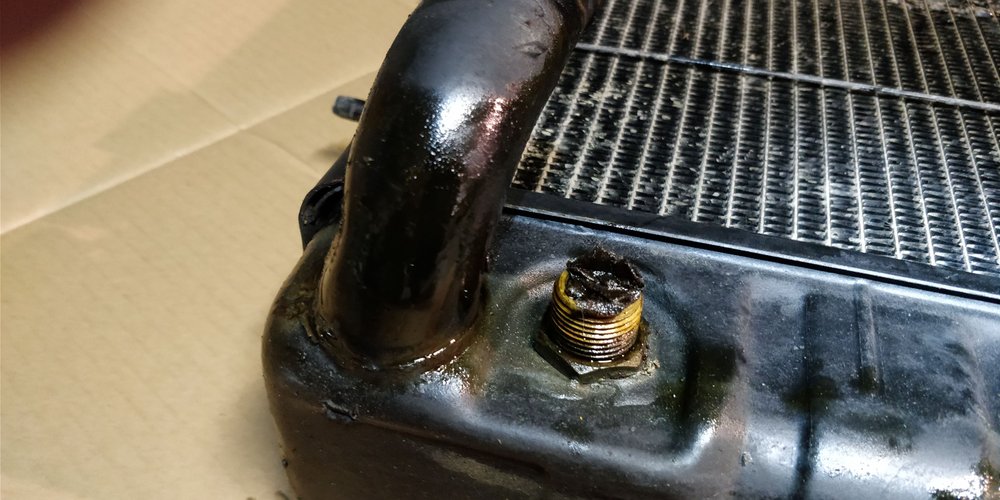

Quick update. That PB B'laster did the trick! All 4 of those nuts came lose easy and came right off. We got the radiator out, and it's now at the local shop for inspection and possible repair. It looks like it's in decent shape to me, but what do I know?
Here are some pics of the scene.
Engine bay with radiator removed. We'll use this opportunity to clean up and remove some sludge areas.
Radiator
Cracked trans. fluid connector
Trans. fluid connector
Oil connector
Oil connector
The boy getting his hands dirty.
