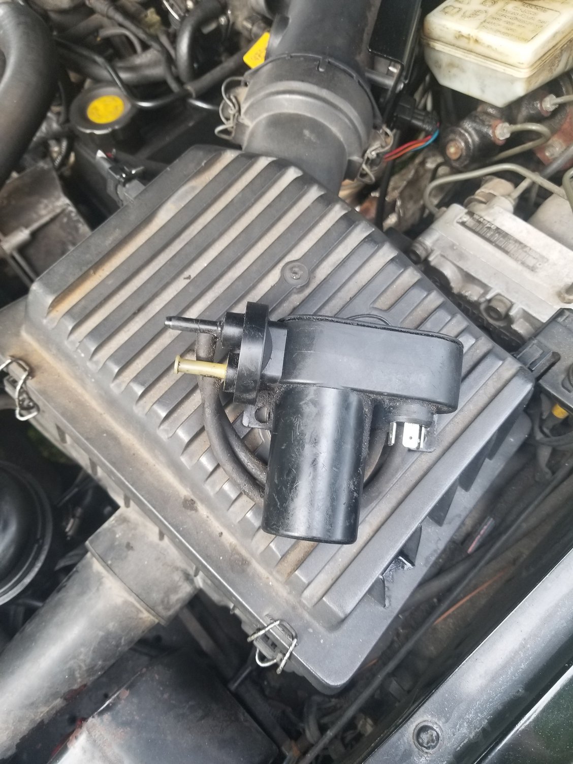

Found this near the power steering reservoir
Can someone tell me what this is and what hoses connect to it

Cruise control vacuum pump actuator. It’s very common that cruise control doesn’t work so looks like someone pulled it already.

One hose runs from that to a T-junction back by the servo.

It's normal home is down below your air cleaner snorkel, below the cutout next to your jack - you'll see a @5/16" vacuum hose entering the cutout - mounted on rubber cushions . Russ
