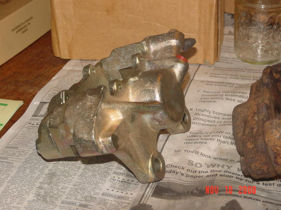

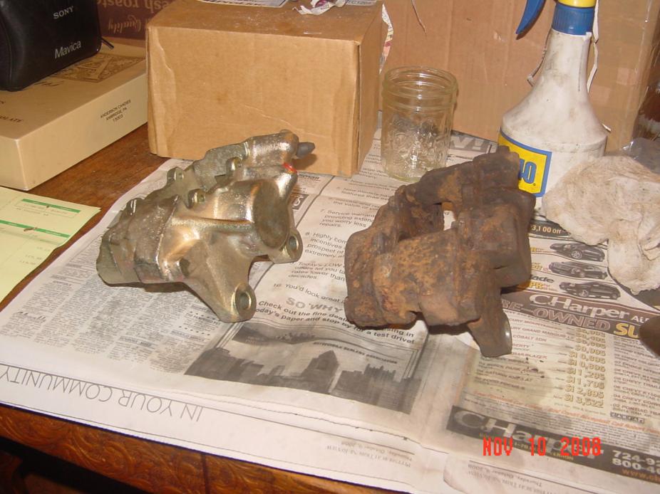

I bought new ProLine calipers from Rovers North for the the rear axle because my old ones were really corroded. My front calipers were ok, but I did get new front brake lines (the formed rigid ones) because one of mine cracked.
At the time, LR wanted a fortune for those front brake lines, RN fabricated a set for me cheap. I think they added those to their line of replacement parts.
The ProLine Calipers have worked fine for me. Here's a few pics.
Attached Thumbnails Front Calipers ? Replacement or Rebuild kit ?-disco-april-2-2010-008.jpg   Front Calipers ? Replacement or Rebuild kit ?-disco-april-2-2010-009.jpg   Front Calipers ? Replacement or Rebuild kit ?-disco-april-2-2010-010.jpg   Front Calipers ? Replacement or Rebuild kit ?-disco-april-2-2010-007.jpg
