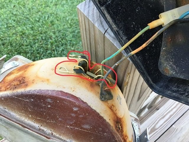

I’m assuming you mean the front fog bulb? If not, are you talking about the whole housing?
Remove the two side screws
Remove bulb housing clip
Housing clip
Pull bulb out and replace
