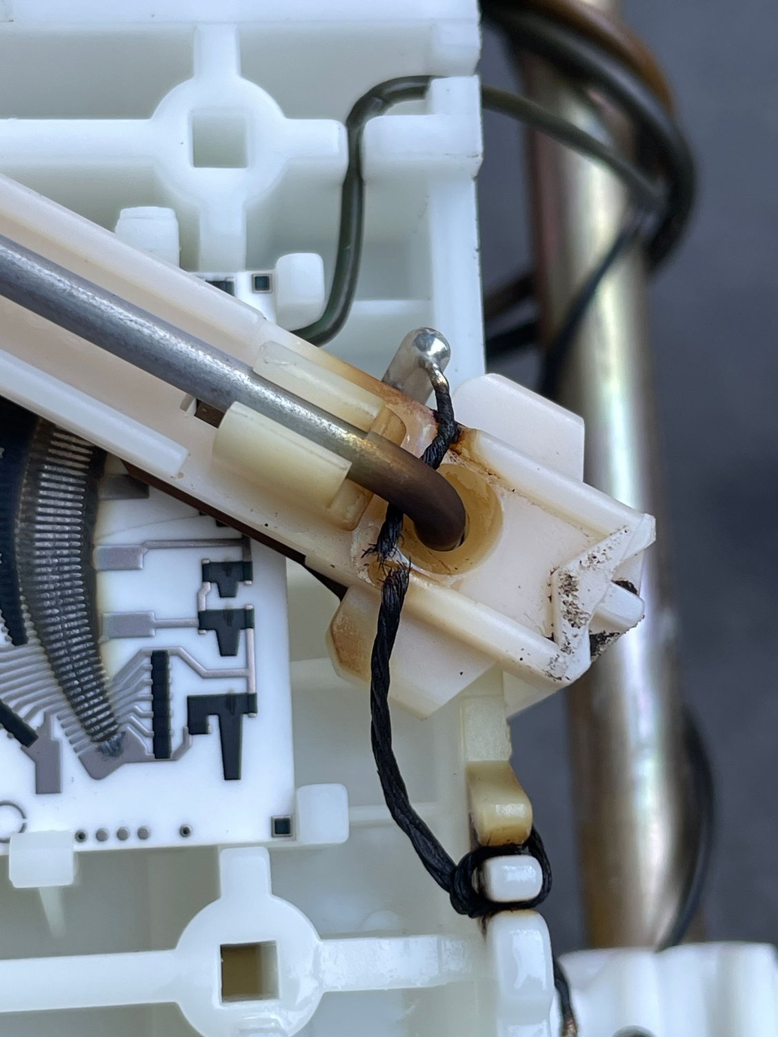

Old Aug 11, 2024 | 07:29 AM
WaltNYC's Avatar
Joined: Mar 2010
Posts: 2,787
Likes: 628
From: NYC
Old Aug 11, 2024 | 02:53 PM
jvarnadoe's Avatar
Joined: Dec 2014
Posts: 232
Likes: 81
From: Erie, CO
Mystery solved. Gonna replace the wire or replace the pump?
Old Aug 11, 2024 | 11:28 PM
JohnZo's Avatar
Joined: Apr 2021
Posts: 1,416
Likes: 397
From: SE Washington State
Looks like too much flexing and bending due to all those fill-ups. Maybe a good reason to always stay at least 1/2 full (optimist), or no more than 1/2 empty (pessimist).
