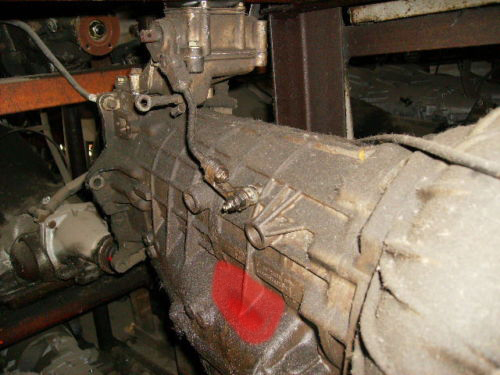

Once I got over the depression of such a small job getting so out of hand, I got to pulling the exhaust. With the pan lowered I can see the pan was not the reason (or not the only reason) for the leak.
On the top side of the flared out section of the transmission where the pan and valve body and such go, there is about a 2"x3" oval chunk of transmission MISSING. I test drove this truck before digging into it and the transmission seemed fine, so that leads me to believe the hole is superficial.
Anyone know a way to do some kind of patch or something? Or is this transmission just a goner?

Pic?
You got the missing piece?

I can't really get a good pic with it still in the truck, but I grabbed a stock pic and highlighted the approximate location, size, and shape... and the missing piece is no where to be found. I'm sure it's on the side of the freeway back in Texas somewhere.

Wow if you can see into the trans you need a replacement IMO, hate to say it
