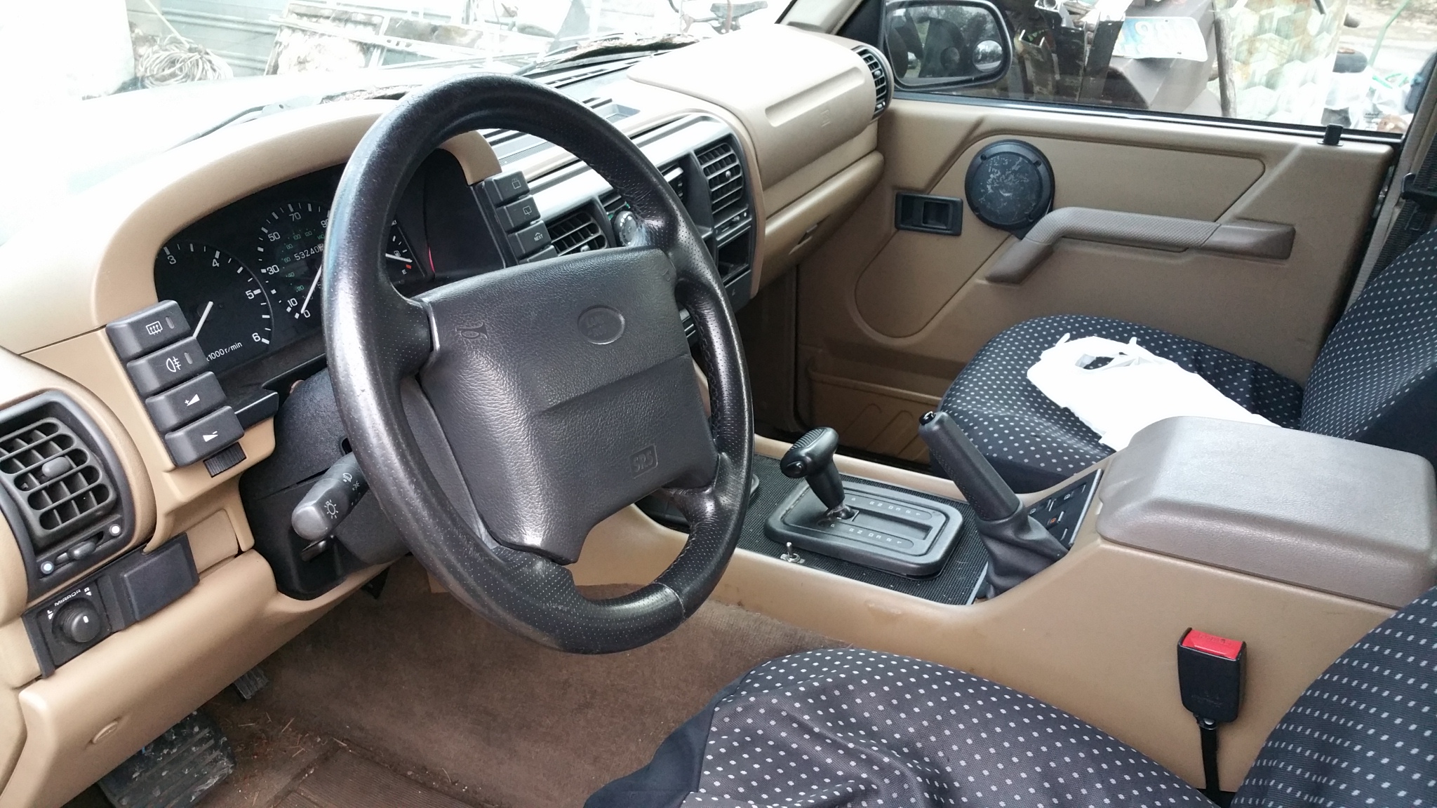

Hello just a little update with some pictures. The order goes first is my 96 4.0 SD which is the one I had so much fun tearing apart the motor and replacing parts just to find the issue was a bad head gasket lol, the second is the new toy a 95 3.9 v8i. And the picture with the hoses is the part that I was talking bout. Tried to get it to fire today but no luck, gonna try some good gas(as the gas smells not rancid but not good) and some fuel additive/cleaner. Will keep ya posted
