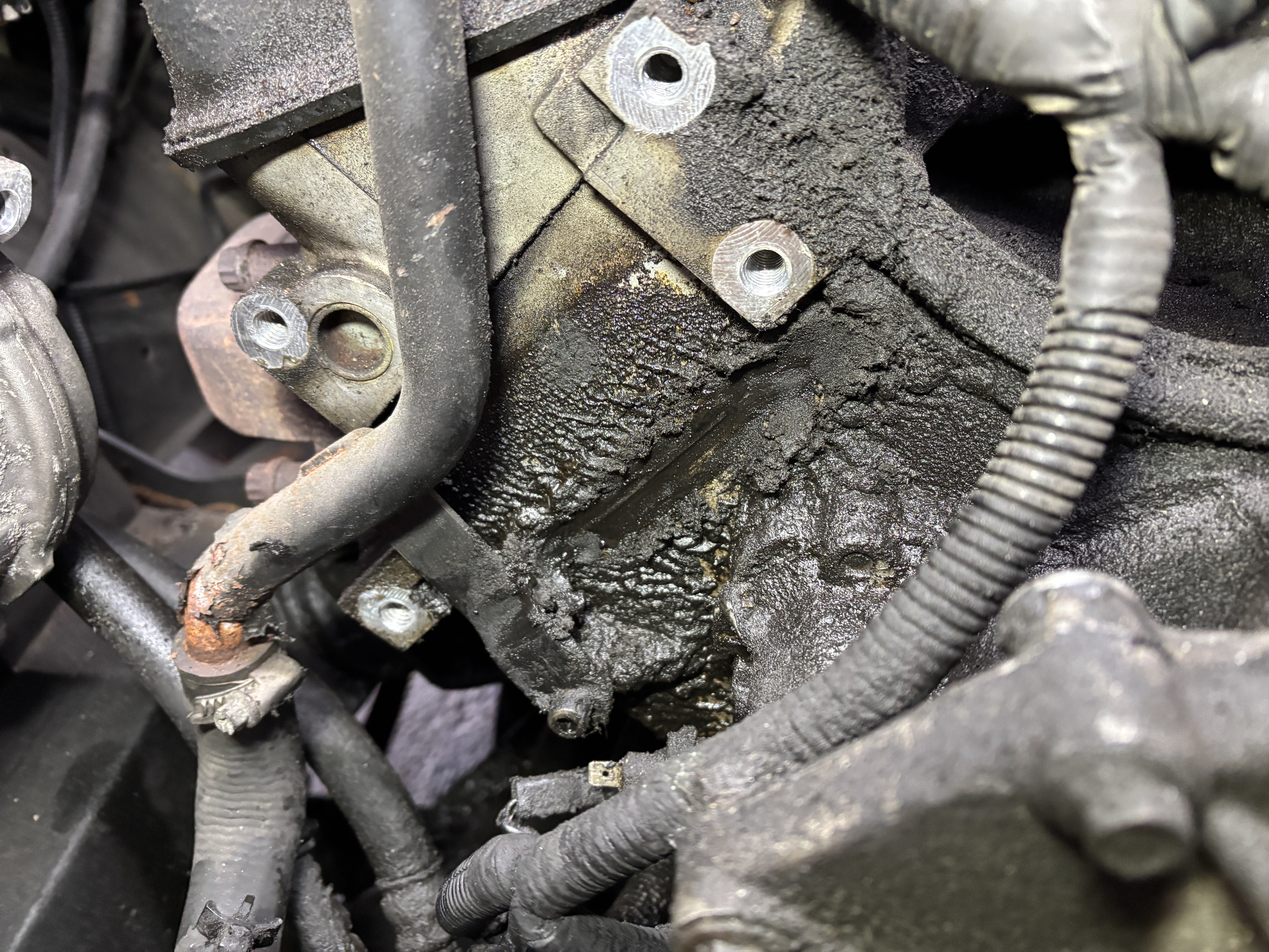

For years I have been reluctant to say anything about head gaskets as it relates to my truck. It is a 1997 that I have owned since new. I am diligent about maintenance, fluid changes, etc. For the last six months my cooling system has been filling with air when the truck sits for more than a day. The gummy mess on the outside of the engine where the head meets the block pretty much confirmed an external coolant leak. I have been driving around with the reservoir cap just finger tight in order to avoid pressurizing the system. That has worked well, but it was time to fix it properly.

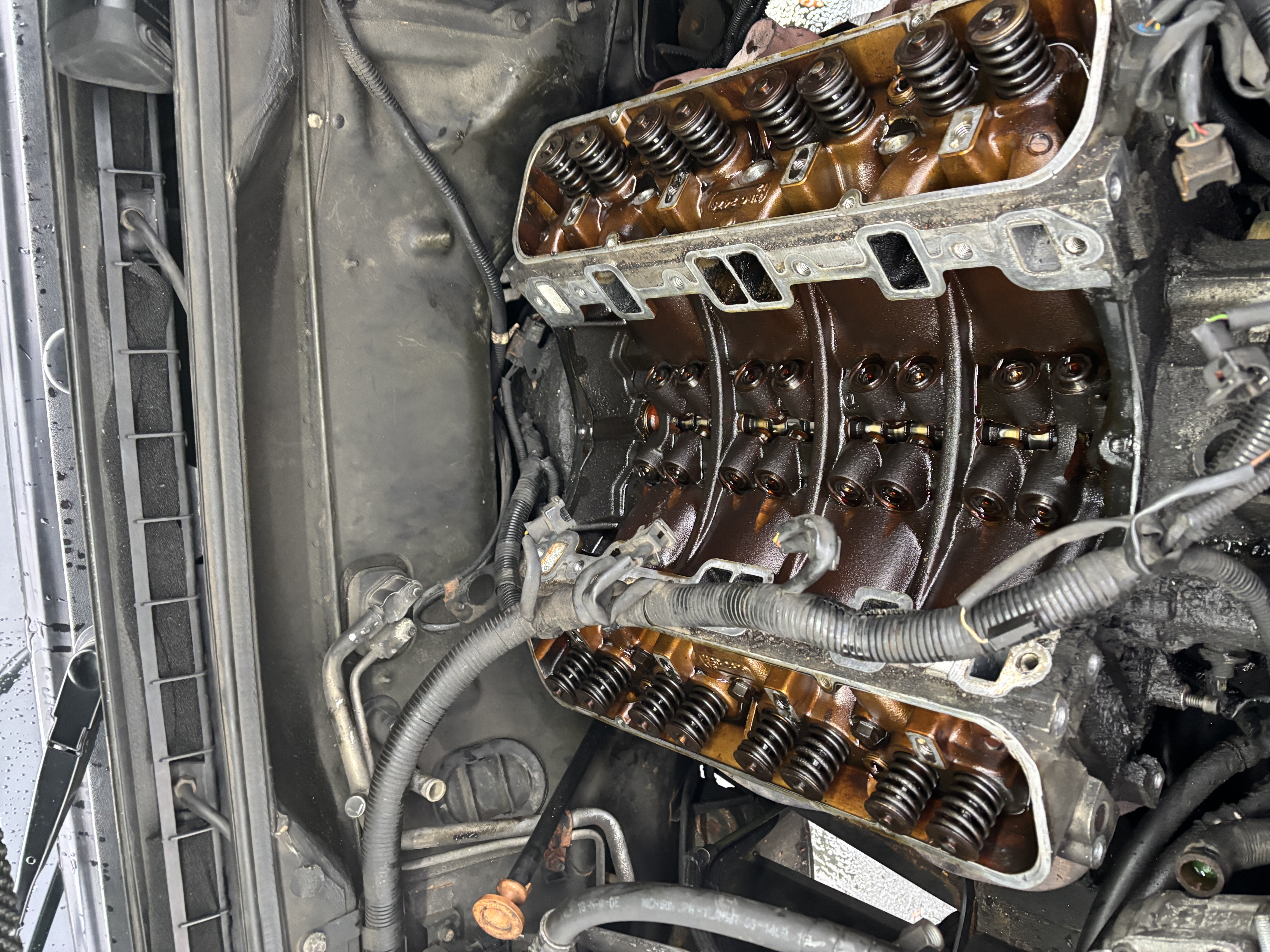

First impression with the intake and valve covers off is that the extensive maintenance has paid off.

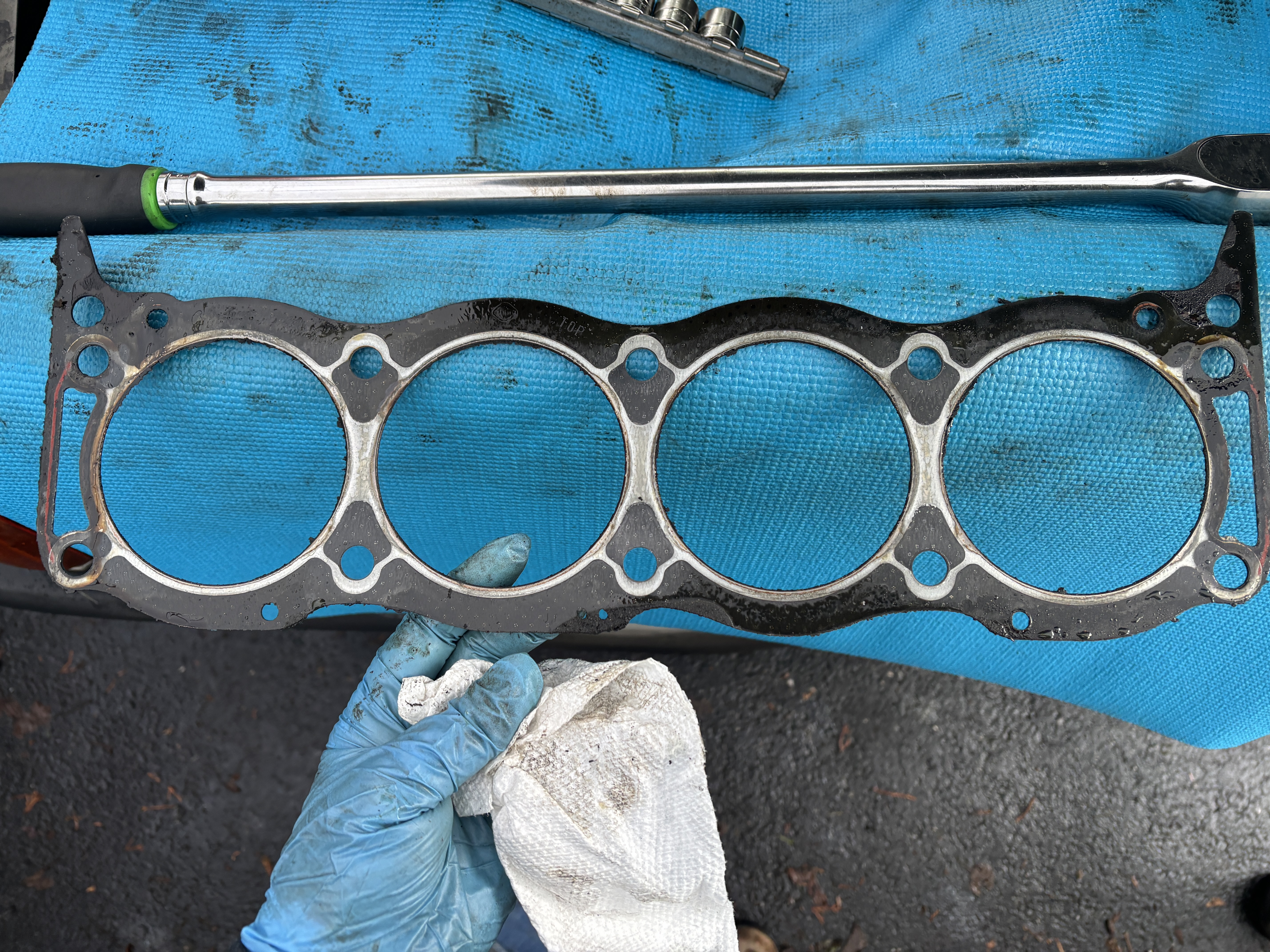

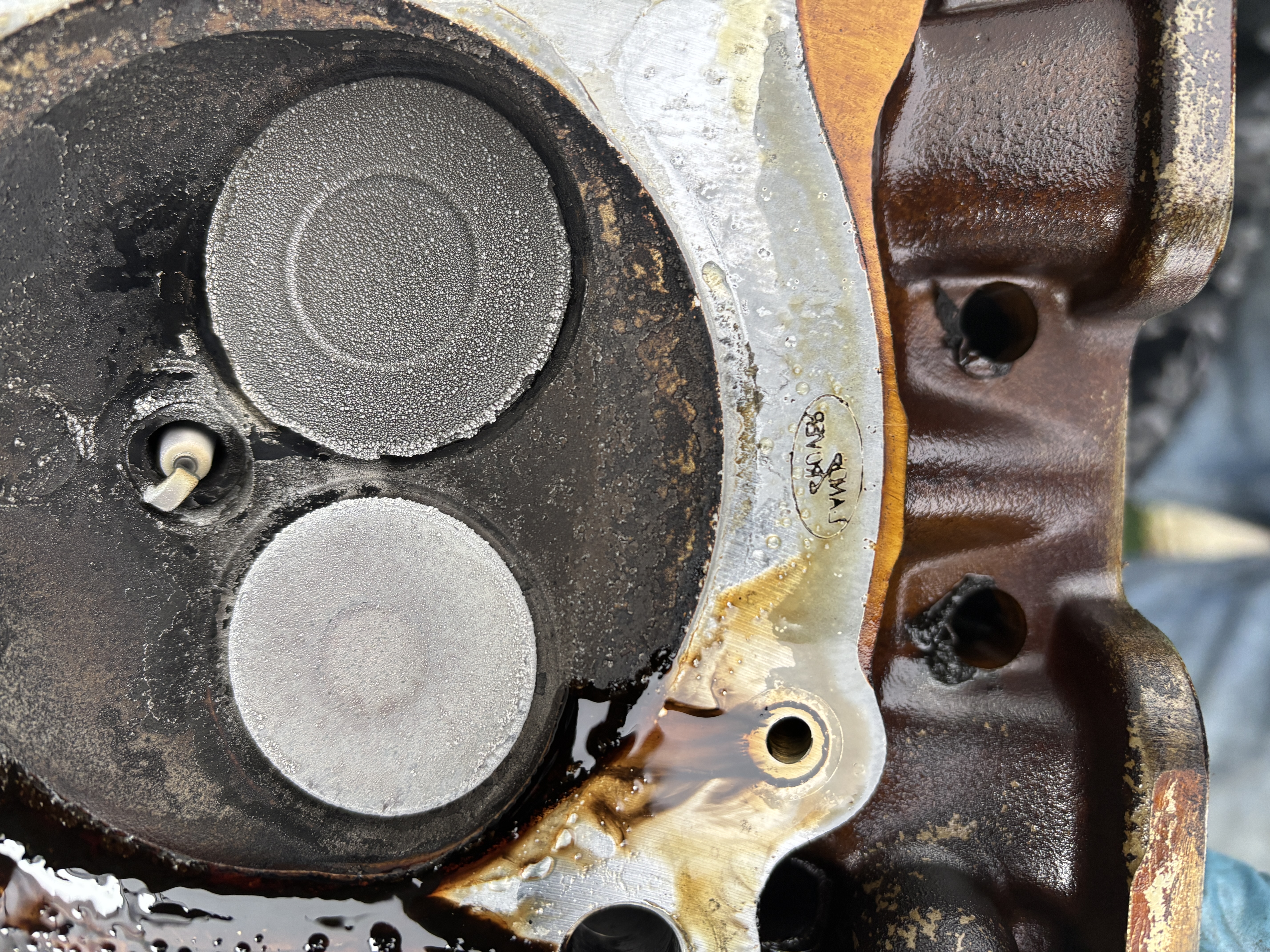

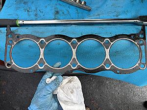

We had a little laugh at the visibility of the Land Rover logo on the head from the original gaskets.
Gaskets looked to be in good shape aside from the area around the coolant passages.
The gummy mess of burnt/dried coolant. I ran my finger through it to expose the seam between the head and block.
Attached Thumbnails Head gasket at 237,000-img_2852.jpg   Head gasket at 237,000-img_2861.jpg   Head gasket at 237,000-img_2836.jpg

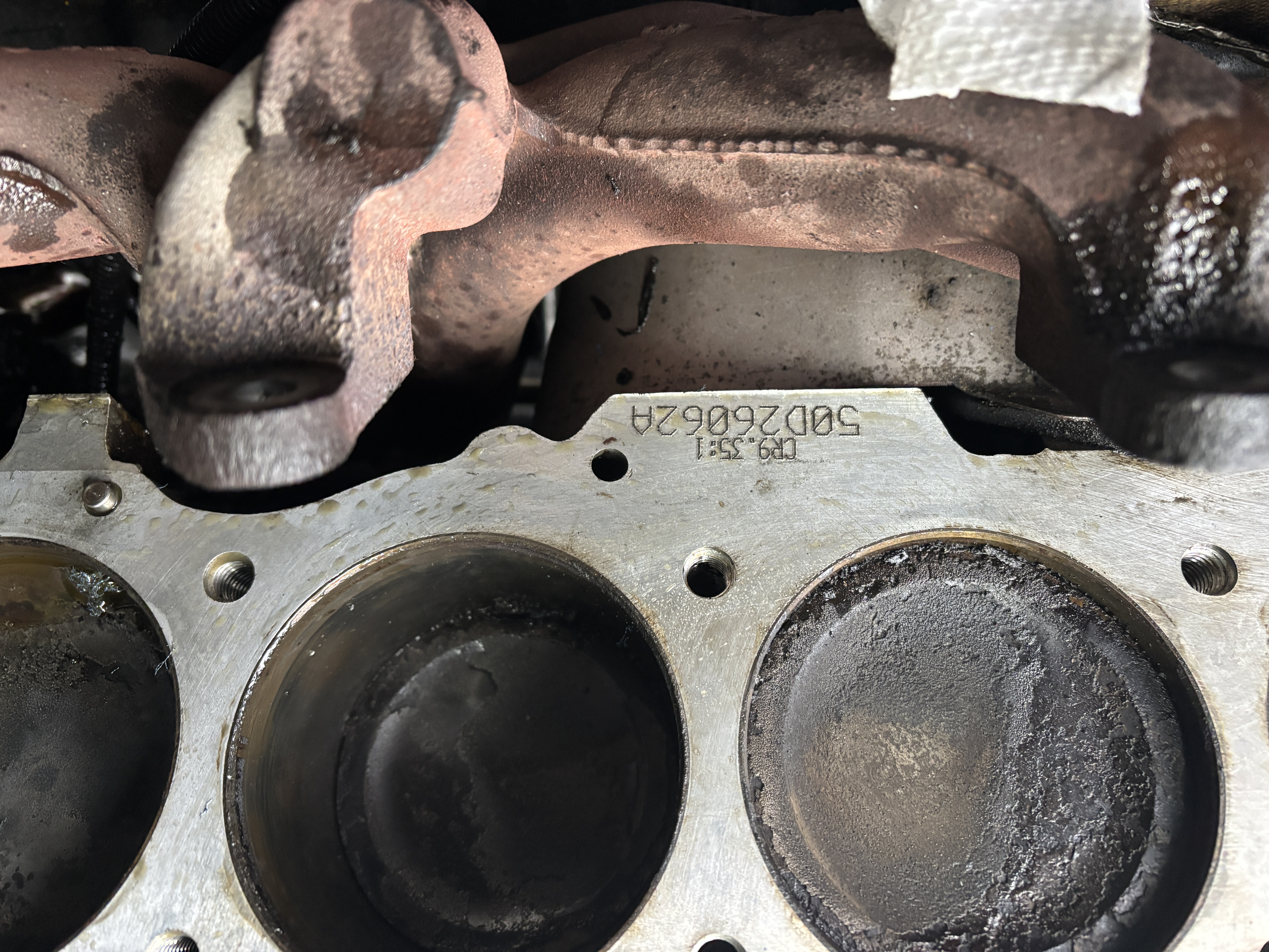

One mystery is the engine number. I cannot find it in any of my resources.
Since I am the original owner I can say 100% for sure that this is the original engine (with the original head gaskets).

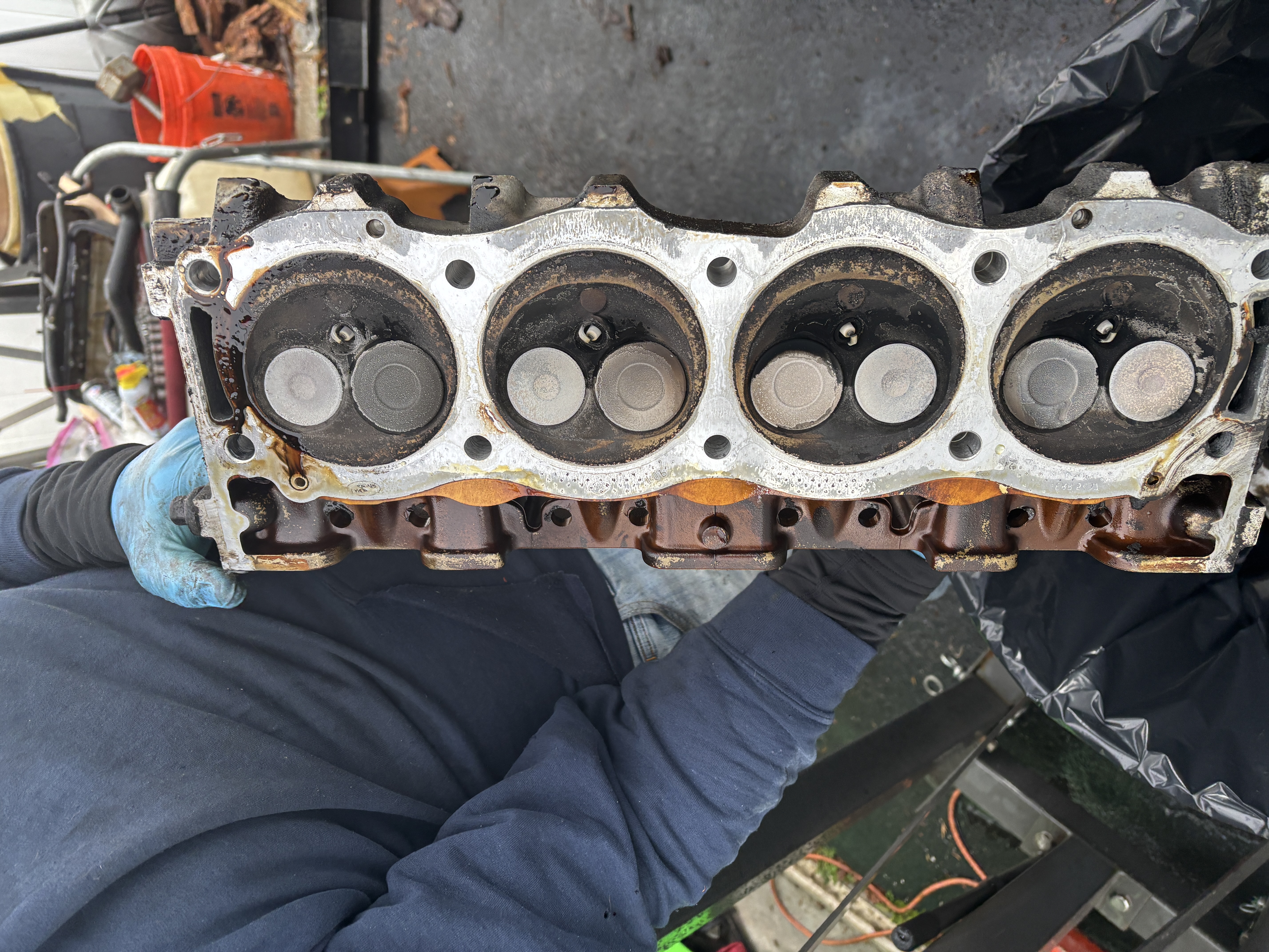

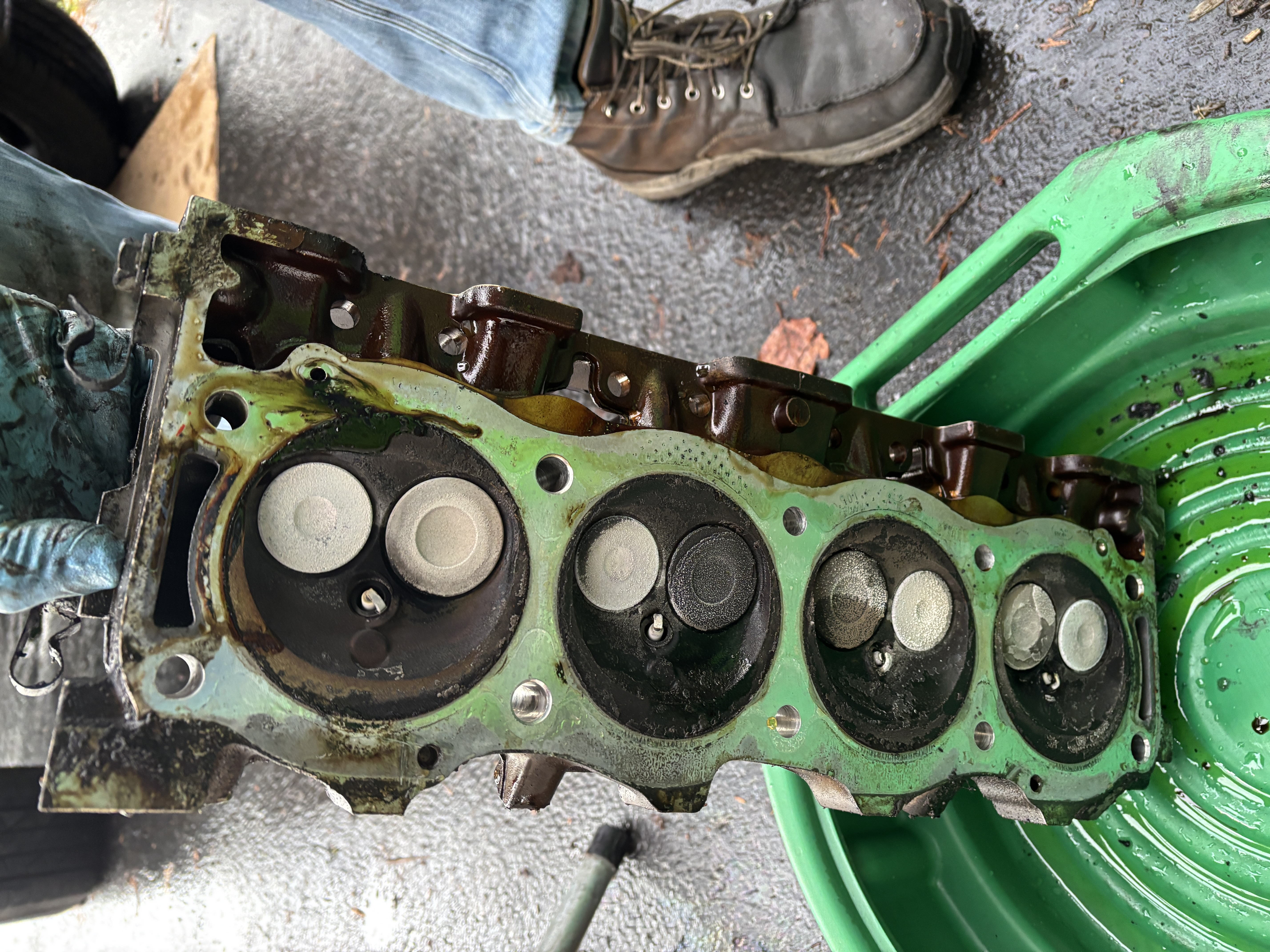

I noticed that the majority of my valves were pale / white-ish. What does this indicate about the air / fuel mixture? What are they 'supposed' to look like in a perfect world?
Attached Thumbnails Head gasket at 237,000-img_2848.jpg   Head gasket at 237,000-img_2849.jpg

Good luck with the rebuild! I saw information online that the "fuzzy" crust on the valves indicates some oil burning. My valves looked similar (at 190k) with intakes a bit towards black compared to exhaust. The 50D engine number signifies GEMS 4.0 L (with cross-bolted crank bearing caps). You might know that already. Roverparts still posts parts D1 catalogs (down in the footer) with details about engine numbers (e.g. pertaining to cams).
