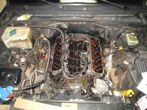

Finally bit the bullet and got into it. I had to add approx a 1/2 quart of coolant everytime I filled the gas tank. My truck has 182,000km (about 111,000miles).
After 12hrs or so over two days I have one head off. I had to stop 'cause I was getting tired and started doing stupid things ( like trying to turn clockwise to get a bolt off ).

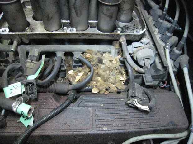

Interesting views so far were: pict 6487: previous owner obviously put some additive to stop some leak...
Pict 6493: some rodent found out that a V8 is a warm an cozy place...
Pict 6516: the valley pan's in good shape. May have been replaced in the past:the end seals were gooped in place with some red RTV: anyone knows if that's what was used in the factory?
Pict6527: Camshaft does show some wear but the lobes don't look too bad either
Pict 6533: took the small hose off the passenger side valve cover vent and found this plug in the opening???There's no such thing in the driver side vent hose . Any clue to what this is?

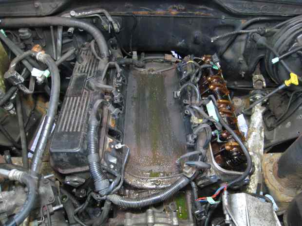

Pict 6539: General view with covers and intake removed. Rusty eh?

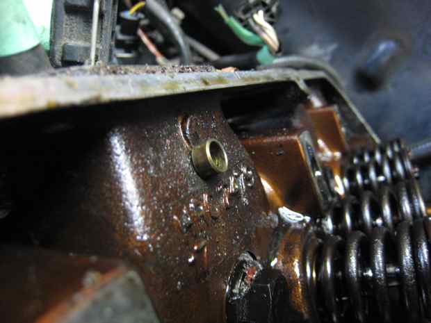

Pict 6543: Found this plus a piece of bent wire in the head. Hell, I once bit into a rivet head while eating my Cheerios...go wonder...

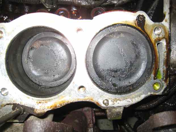

Pict 6552: Bottom left corner: I had a leak there . There's also evidence of stop leak accumulation and caked dirt on the outside.
Pict 6553: Not quite sure but this time it looks like coolant leaked in instead of out .

pic 6543.....that little "bushing" goes in the valve cover gasket where the bolt goes through, obviously there should be 4 per (side) gasket to account for.good luck,

Bingo!
That bushing was missing on the cover seal.
