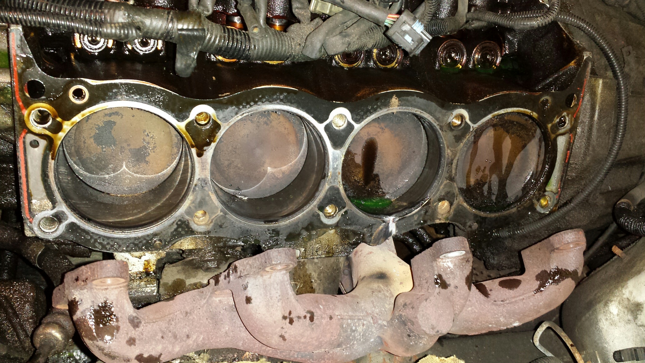

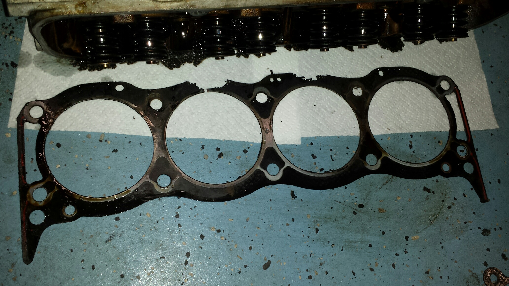

This gasket was really starting to deteriorate. You can easily see that there was no gasket material left between the cylinder and the outside air:
This picture shows the path the burnt gasses were taking out the exhaust manifold side of the heads:
It started out as a high pitched squeak and then eventually turned into a putt putt putt sound.
Head gasket job took me about 15 hours. I did a ton of research on it and studied the RAVE manual a bunch too, but mine went pretty much just like the one in the video I posted in the previous post.
