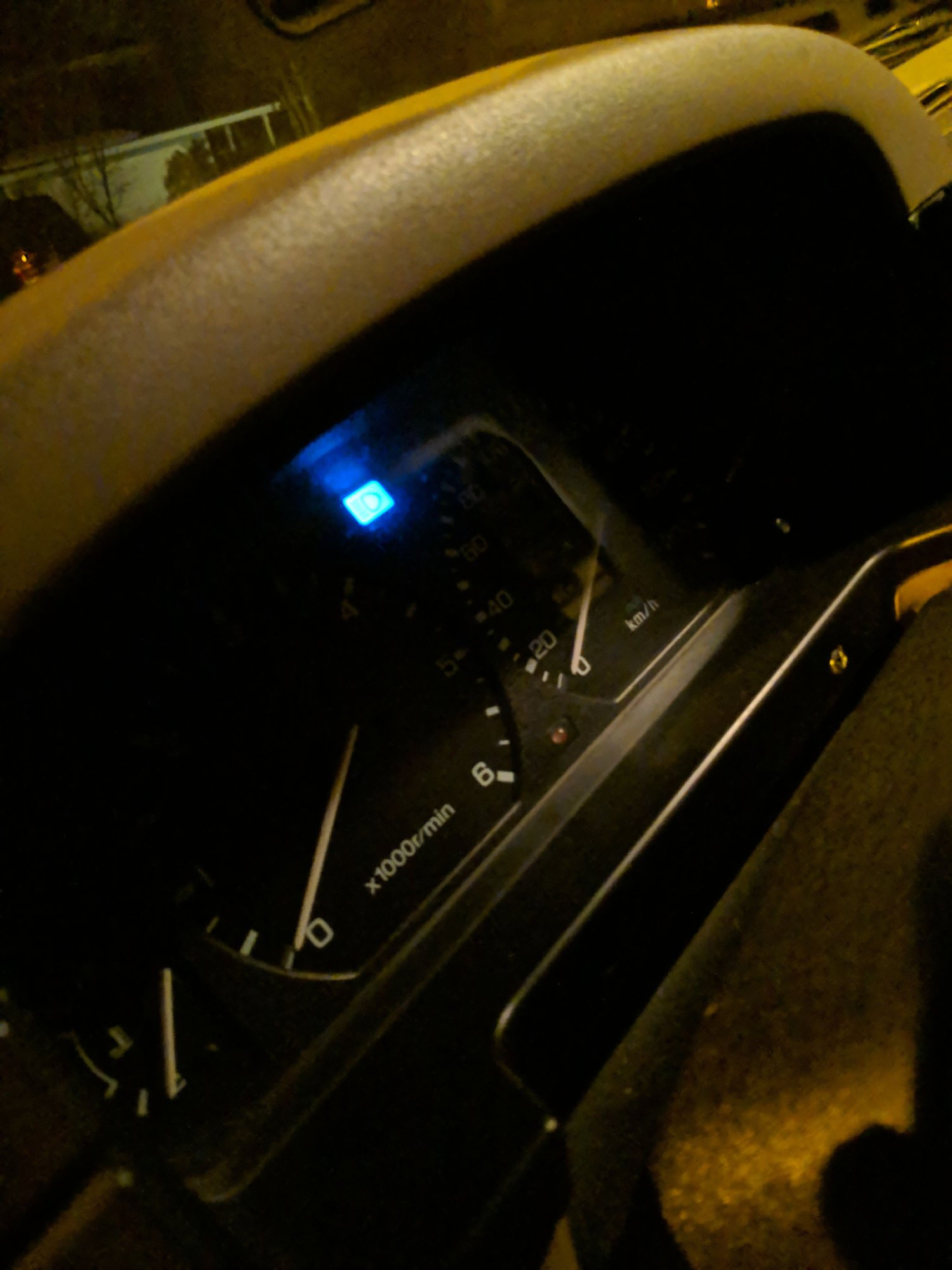

Even after the key is removed, engine off, and the headlight switch turned completely off, this light is still illuminated on the dash
I pulled my headlight stalk out, cleaned it, and noticed that the blue high beam indicator (see picture) on the dashboard remained on even without much power and without the stalk indicator plugged in (my battery is pretty dead).
I have checked the fuses and they are all good.
Is this a sign of a possible short happening somewhere?

It appears that is the case. You have a funky electrical gremlin somewhere. I don’t know what it is though. You’ve pulled all the fuses, checked to make sure there aren’t any exposed wires touching each other or bare metal somewhere, stalk is installed correctly etc etc. Hopefully someone else can chme in with similar problem.
