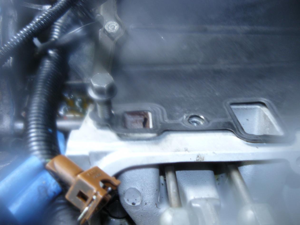

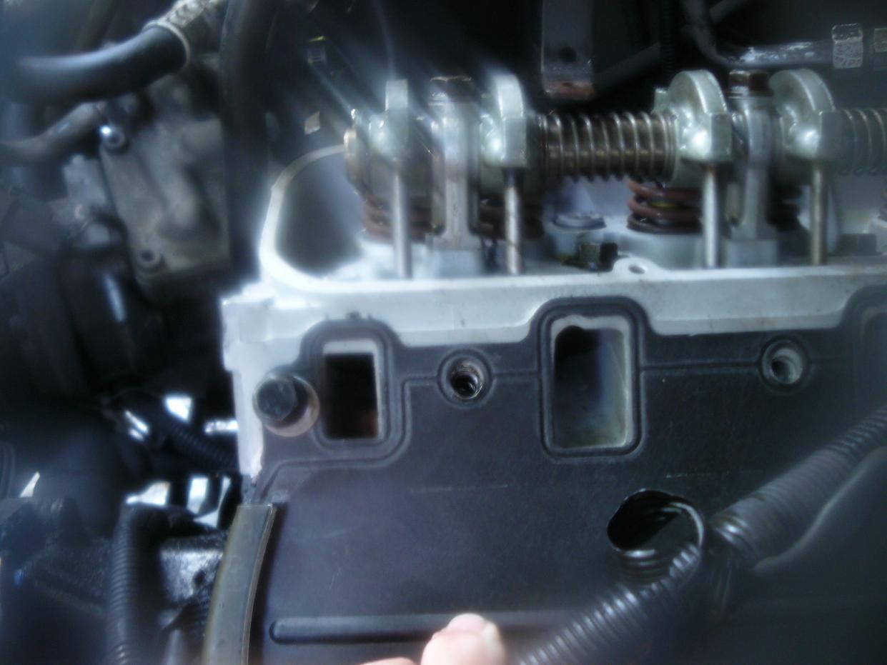

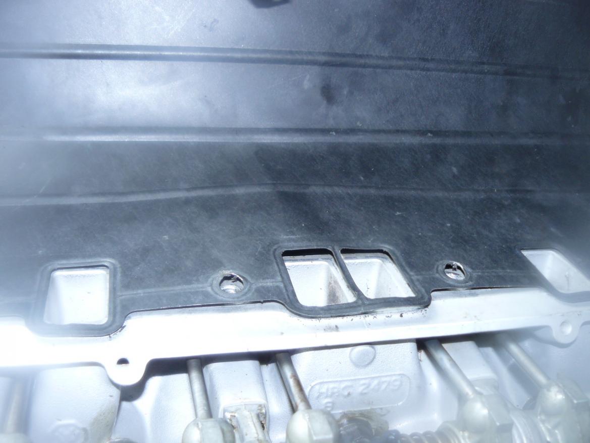

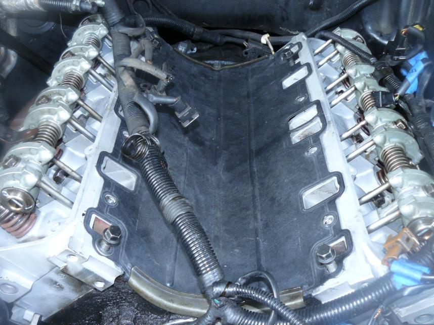

Here's the best I've been able to get this morning, chased inside four times by rain. Wondering if I should enlarge the bolt holes in the gasket so it will start out a little flatter.

Don't lose faith Savannah. It's looking better. I don't even remember this when I did mine, maybe I was just lucky. It just seems like maybe you could punch it down in the middle to take up some slack. But, here's rootin' for ya.

Thanks. Got rained out multiple times today, have 11 bolt holes cleaned out, ready to drill out, re-tap, and helicoil one tomorrow, then start slapping it back together.
