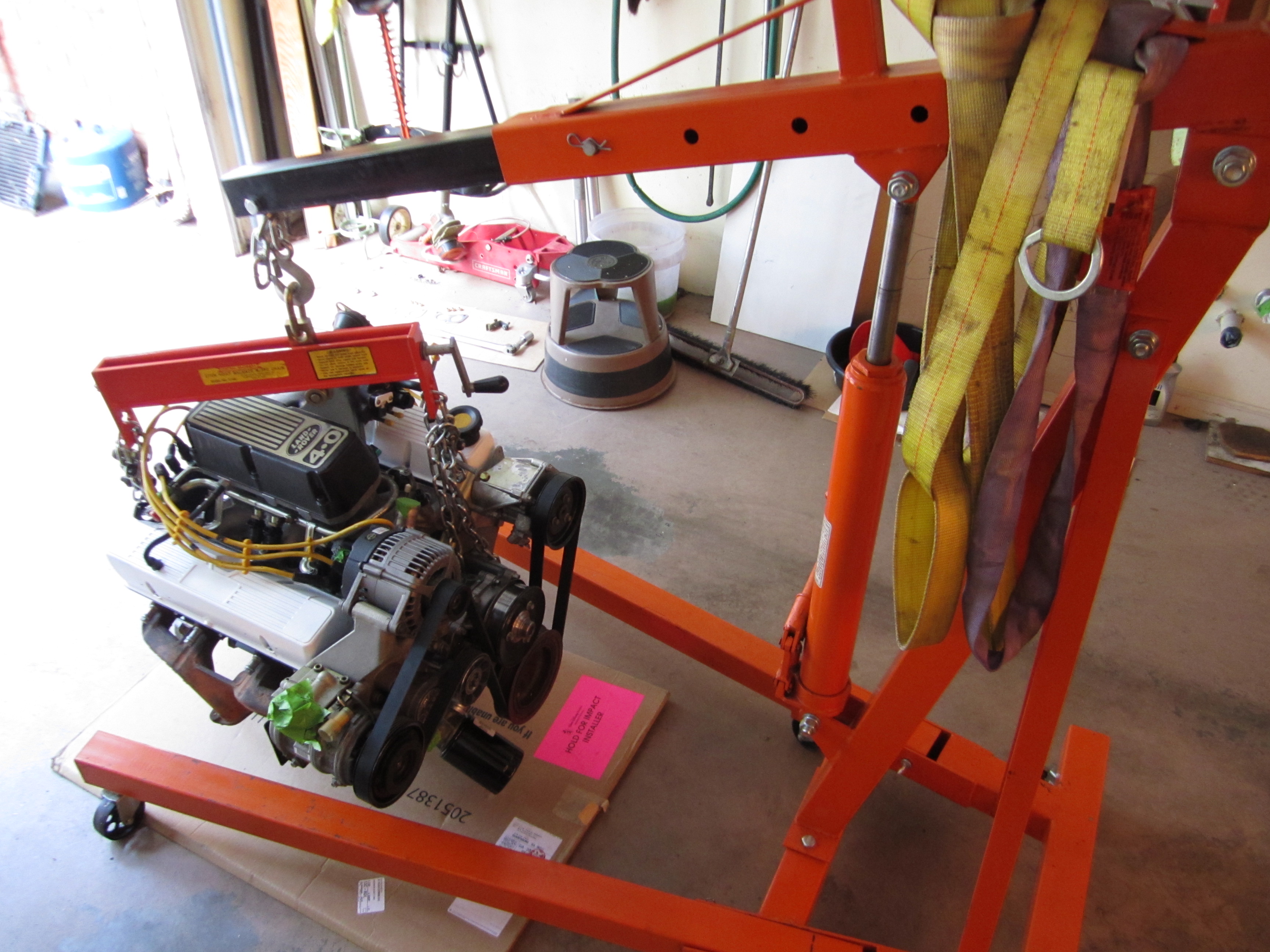

I recently rebuilt the engine in my Disco (original engine with 220,000 miles). I put it back in the truck about a month ago, but am having problems getting it to run right.

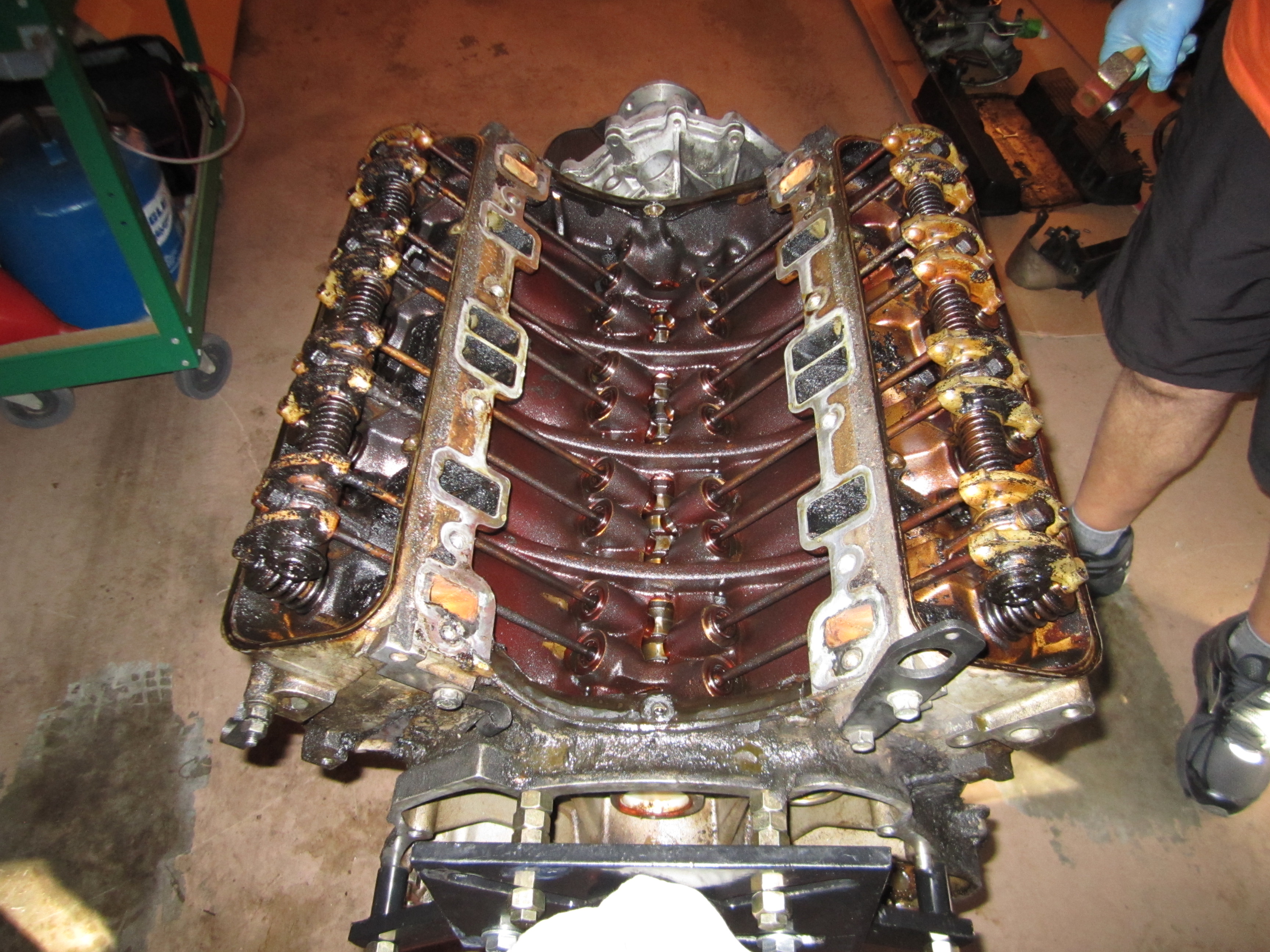

- Also took off the rocker covers yesterday to see if I had a lifter that didn’t fill with oil (causing a valve not to open all the way) or some other rocker problem. Everything looked great. I had no play at all on any of the rockers (which I assume is how it should be).

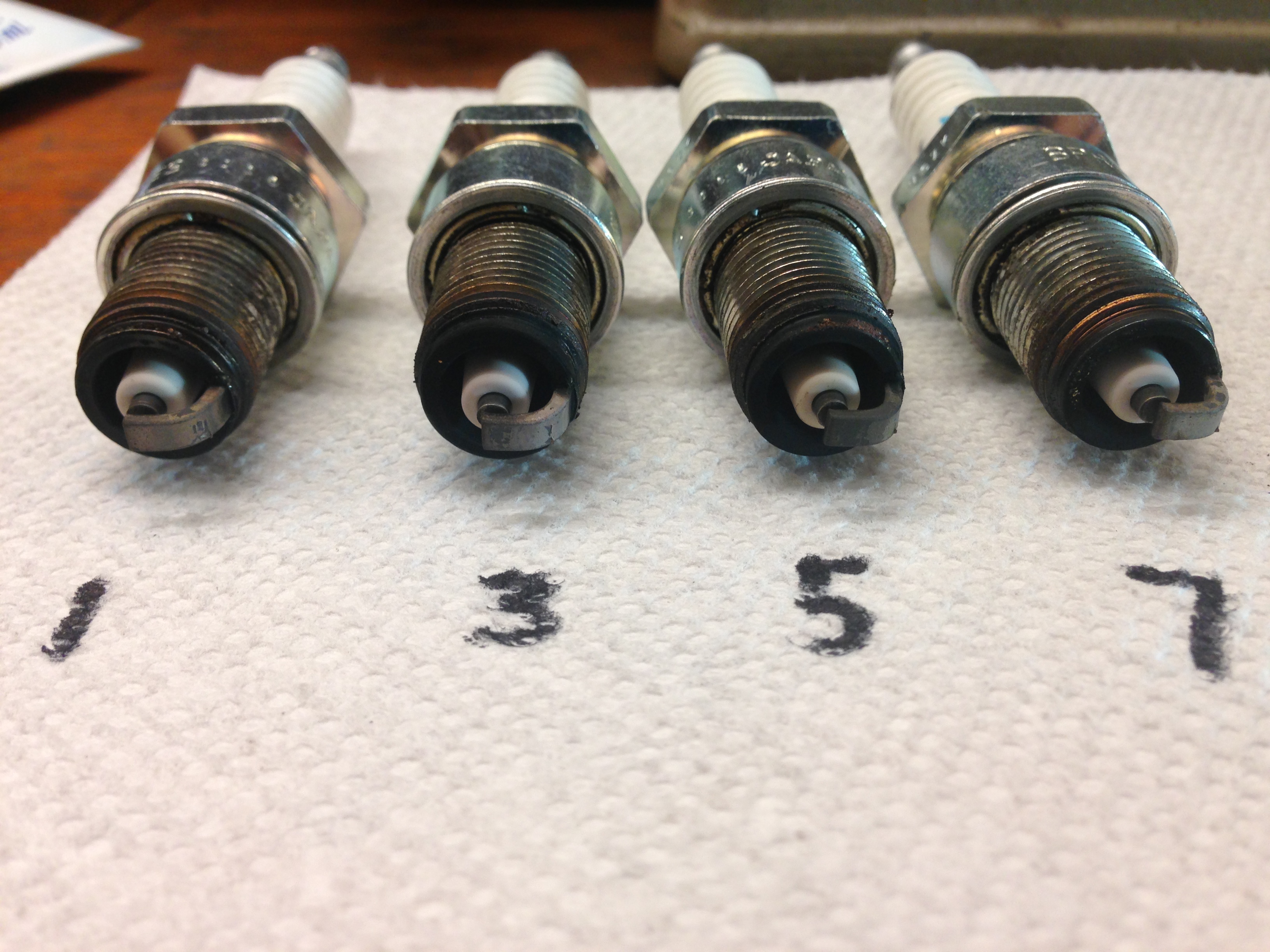

I just replaced my new (1 month old) NGK BPR6ES spark plugs with new Champion 322/RN11YC4 spark plugs. Both sets gapped at .040 - No change.
However, on the plugs I pulled out, I found raw gas on the threads of #5 and #8. The truck hadn’t run for about a day and a half. Is this bad? Do I have leaking injectors?
Wait a minute, #5 and #8 run off of the same coil…. What are the odds that both of my coil packs have a bad coil? I will investigate tomorrow. Do these coils go bad often?
