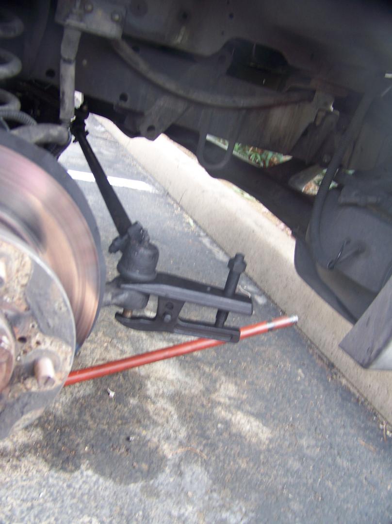

First jack up/secure the truck and remove the wheel, disconnect the steering linkage with a ball joint separator (I purchased the one in the picture from Harbor Freight for about $20). The steering linkage is only attached on to the back of the driver side steering knuckle and the front and back of the passenger side steering knuckle (I believe this will be the same on RHD trucks). Ball Joints are secured with a 19mm nut.

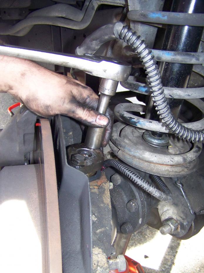

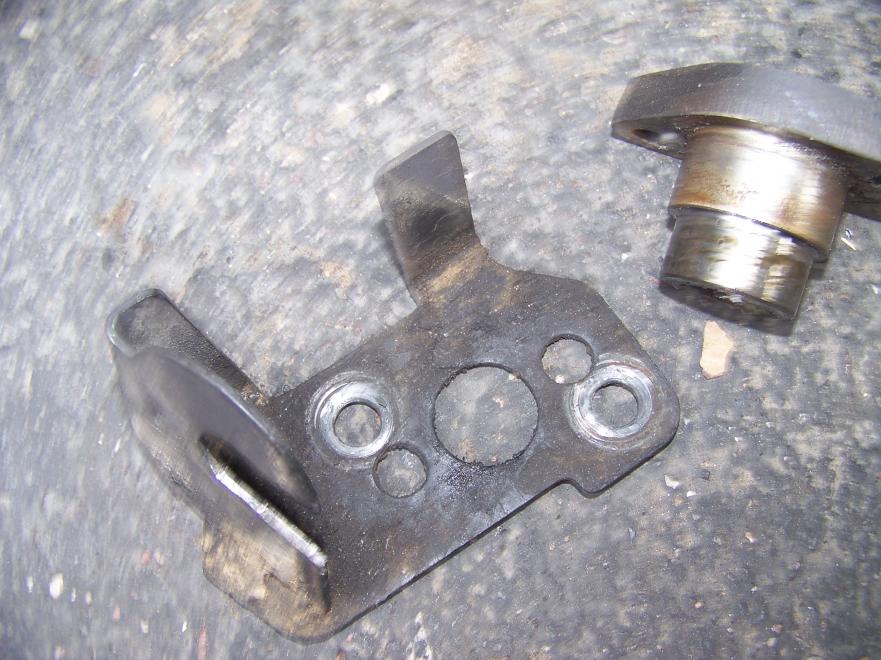

Remove the 2 bolts (I believe they are 17mm bolts) with a large ratchet or wrench. They are initially pretty tight and may take a little effort to break free. After both bolts are removed slide the brake line bracket back and unhook it from the brake dust shield, then remove the brake line bracket. As you may see in my pictures I cut a slot in my bracket with a hack saw so I can easily remove the brake line without needing to bleed the brakes on any future jobs. Once the brake line bracket is removed, gently pry up on the pin to pop it out of the swivel pin housing. Be careful not to catch the shims with the screwdriver as they are flimsy and can be damaged easily.

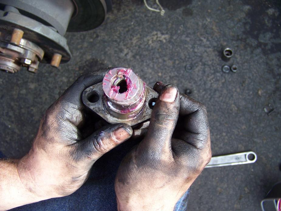

At this point you will merely adjust the amount/thickness of the shims to determine how far down the pin will sit inside the housing (and how tight it will clamp down on the bearing). If all you are doing is tightening the preload then just remove a shim or two and test the tension. I replaced the bearing and the washers before I started adjusting shims. You may want to pump a bit of grease down in the swivel pin housing while the pin is out. Once you have removed a shim or two you will replace the pin back into the housing. My pin would not drop right in so I used the two bolts to press the pin down in.
once the two bolts became snug I would torque them down to about 50 ft-lbs and test the tension from stop to stop with my fishing scale. Once you have found the right amount of shims to bring your tension to the desired range, replace the brake line bracket (don't forget to hook it on the brake dust shield), then apply loc-tite to the bolts, then torque the bolts down to about 57 ft-lbs.

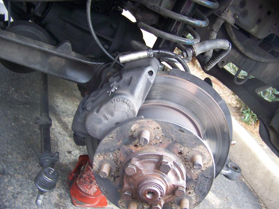

this is a picture of the area with the brake lines out (I reconnected the brake lines together) and the ABS sensor removed.
a better picture of the brake line bracket and the upper swivel pin

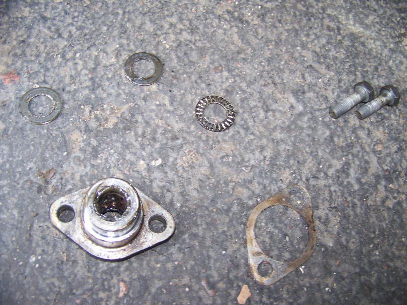

the upper pin, bearing, washers and shims
the upper pin with a couple shims on it
be careful upon removing the pin as the thrust washer often times comes out with the pin
