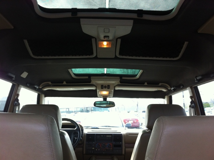

I just replaced my headliner this weekend and had absolutely zero experience with any sort of upholstery.
I have a '98 rover disco that was recently given to me by a family member who just never used it. (I'll only even use it when camping/going to the mountains/picking up boxes that wont fit in my lexus) The car only has 78,000 miles on it, but it's been sitting for a long time so there are some cosmetic issues with it... like the sagging headliner.
I ordered the black material from headlinerexpress. It arrived within a week of ordering it since I liked the black/tan contrast that I saw in photos. Removing the headliner was honestly very easy. All in all, that part took me maybe 20 minutes taking my time to make sure that I got all of the screws properly and placed in an area where I wouldn't lose anything.
After it was out of the car, I used a wire brush to get all the excess glue off. This part, honestly, sucks. It took about 30-40 minutes to get it all off and made a complete mess.
I used the 3M Hi-90 adhesive. sprayed it on 1/2 the fiberglass and on the cloth i was going to lay down. Let it sit for a minute or two before applying it. It wasn't as easy as the pictures made it look >.> . The corners were difficult (remember to stretch it sideways so there is no crease in the front corner) and there are a lot of areas where you really have to stretch it (sunroofs). I made a few mistakes when doing it, but fortunately most of them are in areas that are hard to see or covered by interior trim. I'd say I'm about 90% happy with the job that I did, but it's infinitely better than the sagging headliner and it's not bad for a regular guy's first attempt.
The entire process took me about 6 hours.
While I was up there I was sure to check out the sunroof drain pipes and everything. Fortunately mine looked seriously brand new, so no need to repair/replace them.
Here is the obligitory pic of my finished product:
