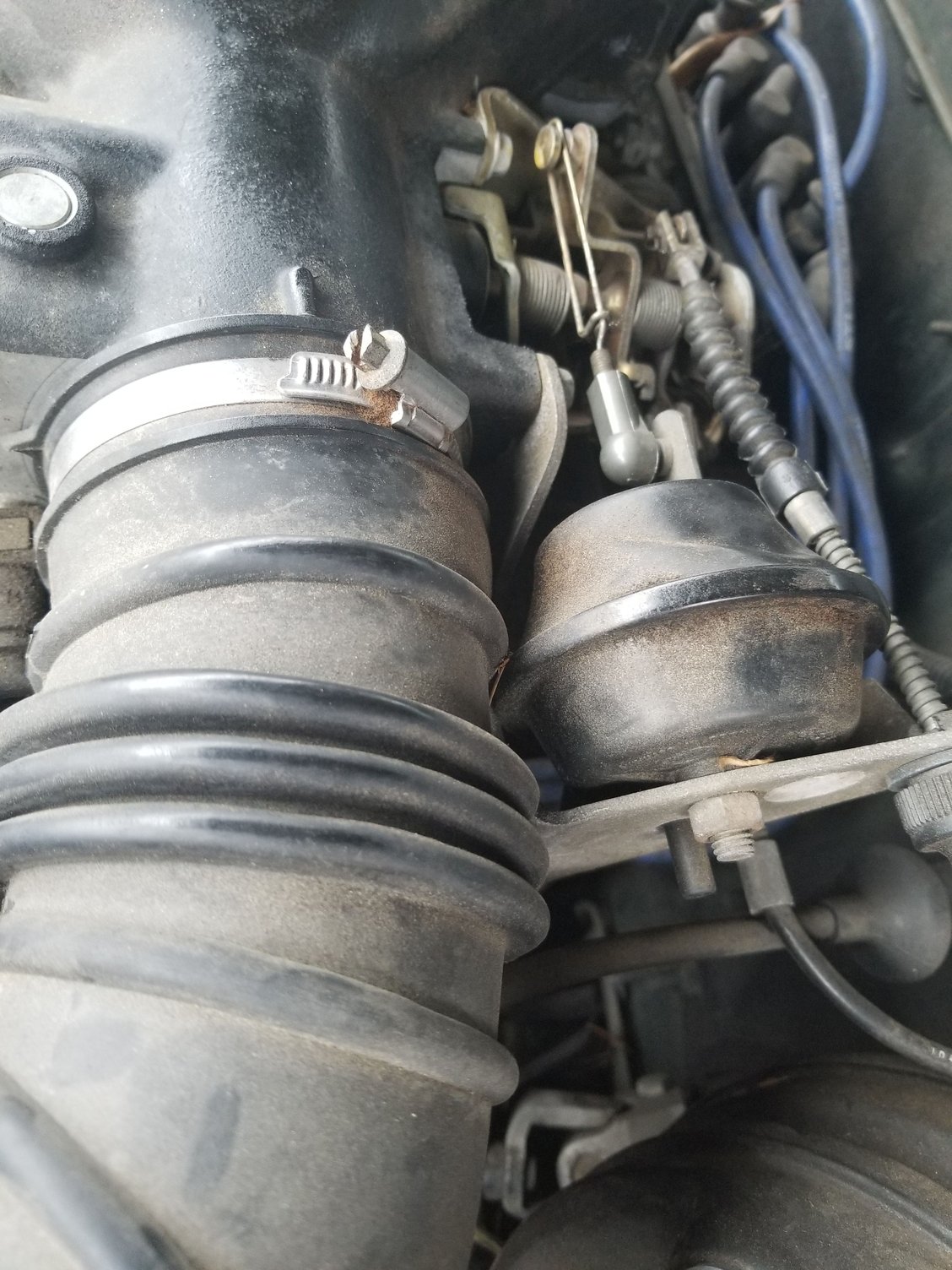

Hi All, my 1999 Disco I is idling too low. To the point that it intermittently cuts out on a rolling stop but cranks right back up.
I know some cars have screws where you can adjust the idle but I don't see how to do it. Please advise. Thanks

The pics of the small silver plug on your plenum is actually a cap and you can punch a small screw driver through and lift it out. Under that is a hex head screw for setting the base idle....... Funky Cole Medina....... You have to count the turns out when removing to make sure it's in the same location once cleaned as I've found oil/carbon buildup in that series of venturi through the plenums idle passages. The IACV is located within that area, both control the amount of air entering around the throttle plate.
As the fellas said, make sure the Idle Air Control Valve (solenoid) pintle (thing that looks like an arrow tip) and bore are clean of carbon AND a little carburetor cleaner around the throttle plate. venturi ports and bore would probably rid the low idle since these motors suck allot of heavy oil vapor through the plenum....... YMMV.
