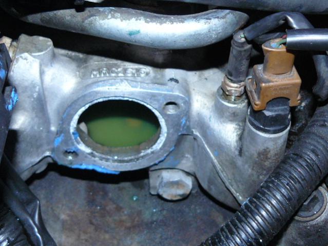

That is a good point. On your scanner, what does coolant temp say when truck is cold before starting? Should be local temp, but my D1 will read -40F if sensor unplugged. ECU coolant temp sensor has two wires, gauge has one wire, located next to thermostat. Also, I think my throttle % is a little different than yours. Pix of scanner (with cardboard in front of radiator at idle to show heat gauge issues).
Attached Thumbnails I could use alittle help...-p1120328.jpg   I could use alittle help...-p1120320.jpg
